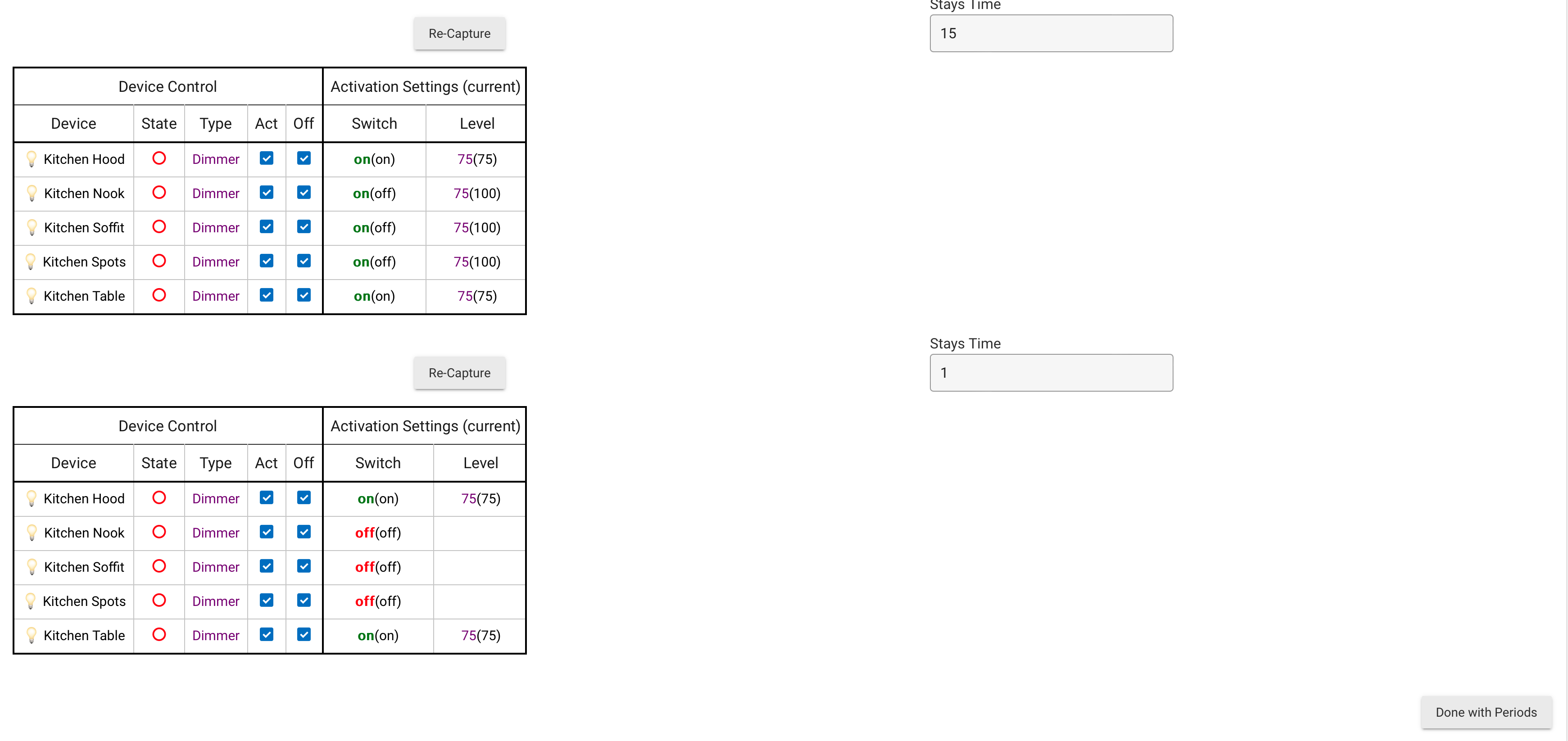

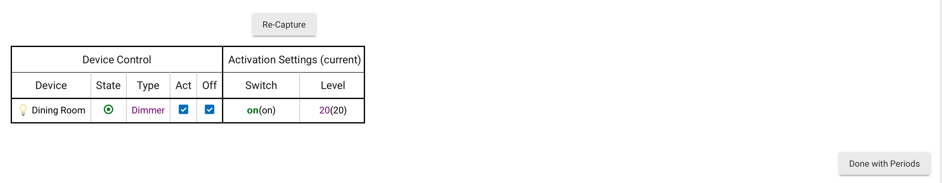

Here is the screens with the missing modes.
Summary
Here is the result after making a change.
Summary

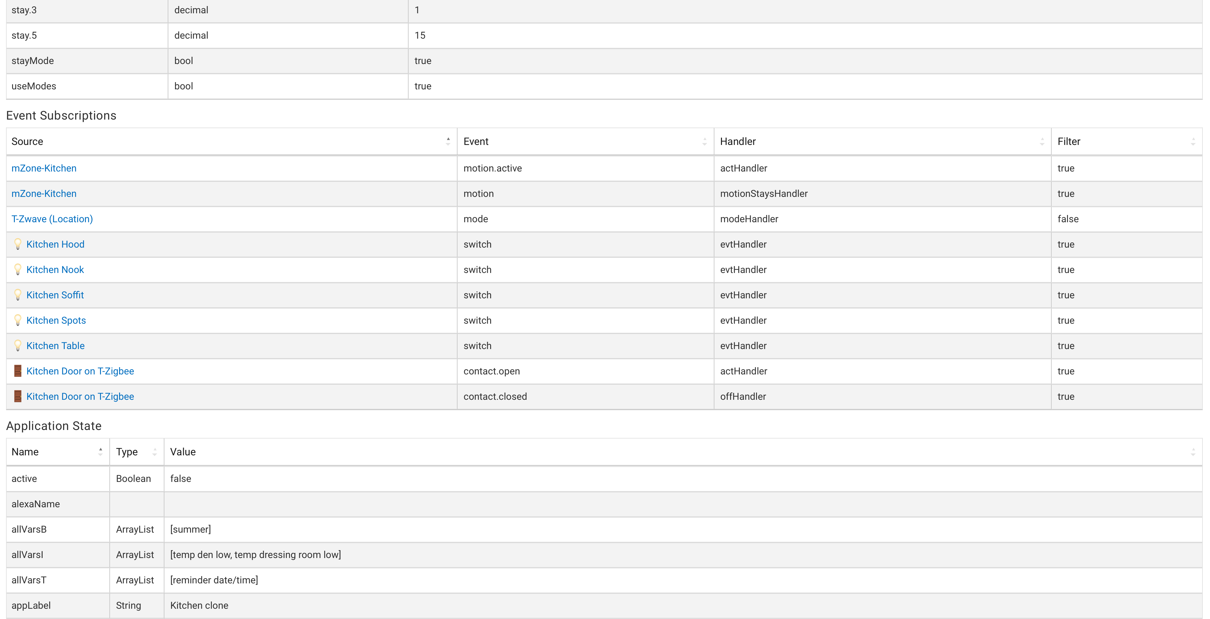

Here are the details for the rule.
Summary
