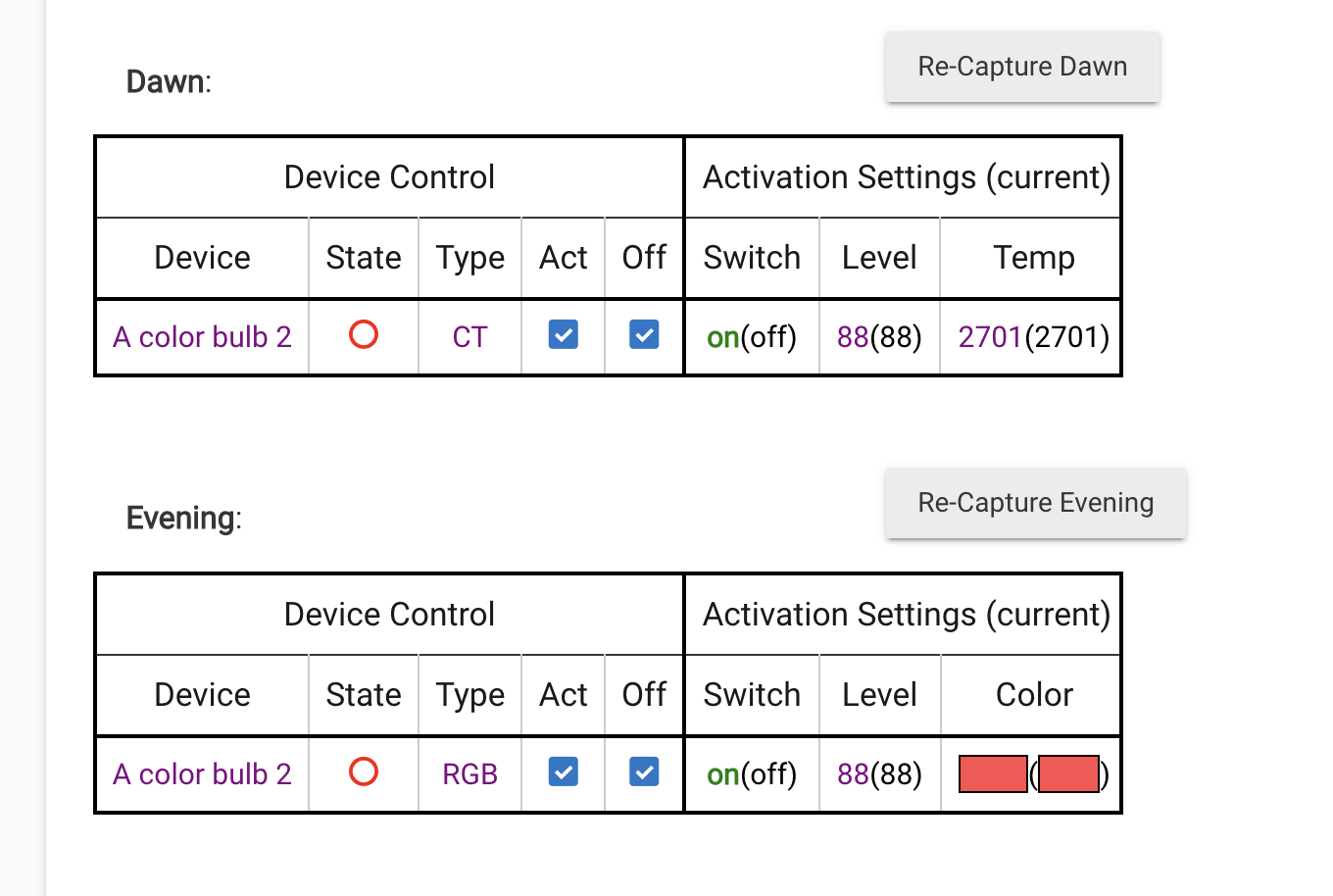

You can do this. You can set the device type separately for each mode or time period. So for one its RGB and another its CT. Like this:

Okay. Thats brilliant. a hidden gem I never thought of! What I did was use Mirror to create a 2nd, virtual unit as CT.
Then I mirrored the CT back on itself to the RGB. So if I issued ct command to the CT device, boom. If I issued RGB command, boom chacalaca.
of course, your way is better - and now I'll go rip out the virtual excess, and do it the lean way!
Here's my solve (which worked perfectly!)
