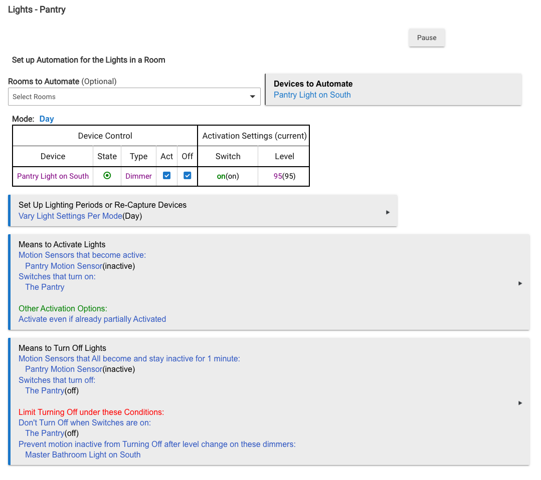

I have a RL that keeps getting stuck "Motion Off Disabled" when the switch configured to disable turning off is NOT turned on. The fix is turn that switch on then off and it starts behaving correctly again. This has happened several times in past month.
Screenshot 2025-10-31 at 10.42.14 AM
The switch has been off for 5 days - but the RL is stuck again right now.

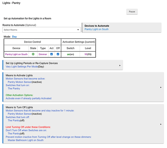

Maybe it is not the pantry light causing the issue, but something with the Master Bathroom Light Dimmer?
The message is "motion off disabled" which is specifically what your last limit is in the RL app. I do not use that option. So, I have no idea what resets the motion inactive restriction.
Good eye - that was not supposed to be there at all. Seems that toggle was turned on (or maybe when it was added as an option) and a random dimmer was selected.
