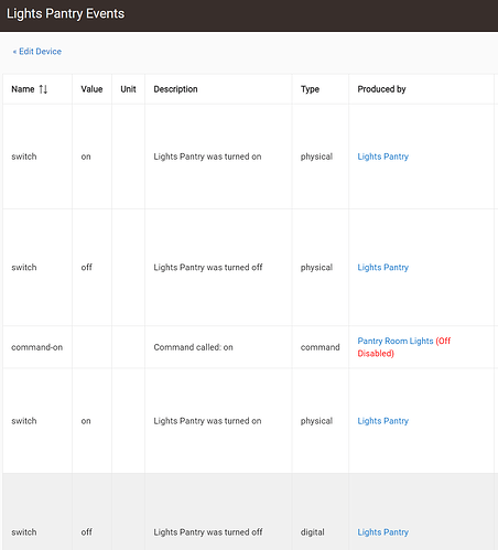

Thanks for the room Lighting fix, now seems to be working as expected with inbuilt aeotec nano switch driver (see below screenshots). However the inbuilt Aeotec Dual Nano driver does not trigger the "Physical Switch", how might i go about requesting this driver to update "Type" column in the device to show "digital" or "physical" or "command"? I can see these details are listed in the "Description" column but my understanding is they need to be entered by the driver into the "type" field for the application to work correctly.
