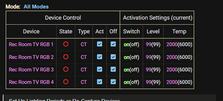

How is your Room Lighting instance configured? If your devices support it, it should create an activator with both "Set Color" and "Set Color Temperature" commands that will work for either color or CT. Is that what you're looking for but don't have? If so, it's probably something related to your RL configuration. But from your initial post, it's not clear if it's that or just your actual devices missing some comands. Can you share more information about what is missing for you where?

RL makes you set an activation type in the activation table, yes, but if you need something more "dynamic," you can use time periods or modes to vary activation settings (including activation type) based on that. But in any case, if you have it create an activator, it should give you full capabilities on that device -- e.g., "Set Color" even if you only have a single activation table and it's set to "CT," for example. These two issues aren't really related.
It sounds like that's where the breakdown is for you. I'm not sure why, but as I suggested above, sharing your RL setup should help figure that out.

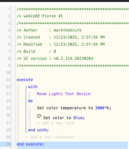

I tried creating a test activator device in room lighting.
I have no need to do anything with it, but it appears to have the attributes for both RGB and color temp, consistent with what @bertabcd1234 said is expected behavior (and not consistent with what the OP is reporting).
And here’s a webcore piston with the activator device I just created. No issue creating actions to set color temp, and also set color.
:man_shrugging:
Ok, now I have to go try this again. :wink:
I had no Set Color Temperature in WC only Adjust ....

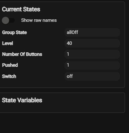

What does the device detail page for the actual device show? Most interesting would be what commands you see.
I changed my Activator to CT and tried all the Activator device drivers and I don't get what you show.
No Set Color in WC and the states are limited.

I would not suggest changing the driver RL assigns to the device. What was it originally? And can you look at this?
This would be from the device detail page, not webCoRE:
I don't see anything unusual in your RL configuration, but I'm curious what the actual device looks like.
Ok.
Fresh Activator and I let RL decide on the driver; it picked the one I tested but now I have states like @marktheknife and WC gives me Set Color Temperature. :slight_smile:
