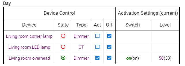

All the switches and levels are set as expected, but my activator device "Living Room Lights" is OFF, not ON as expected since everything is set as per the scene.

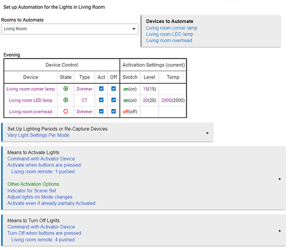

It seems to happen reproducibly, not only in my living room but in other rooms as well. I turn everything off, turn on the activator switch, and then after a few seconds it will turn back off.
Everything is still set according to the the activation settings

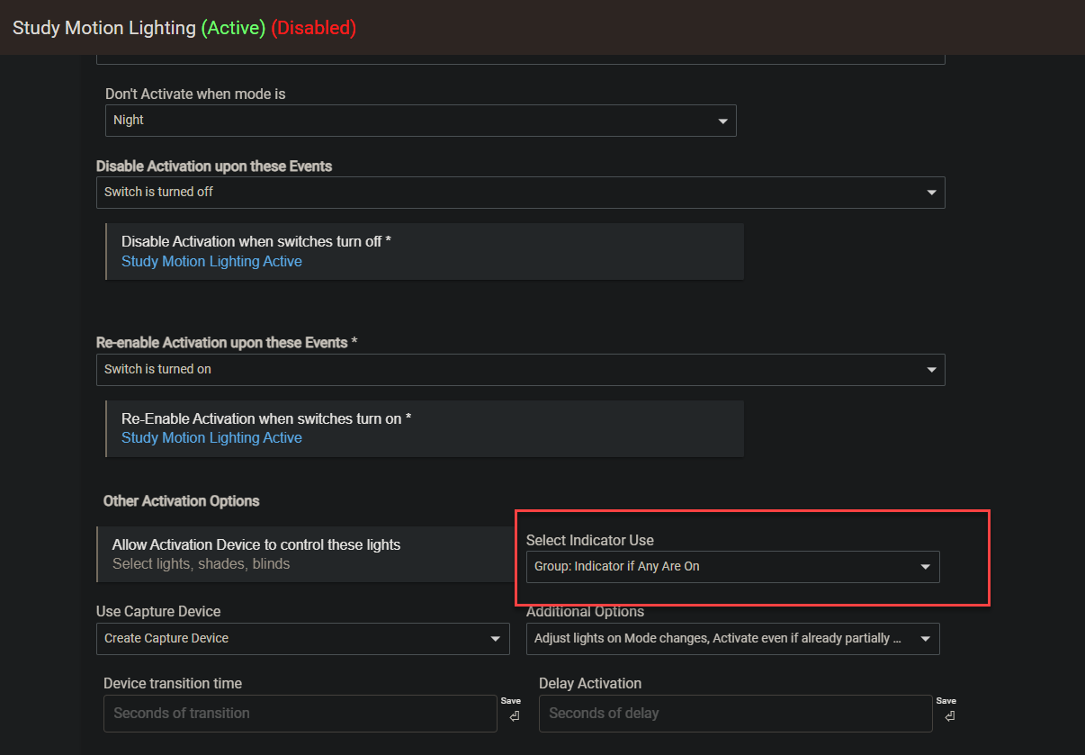

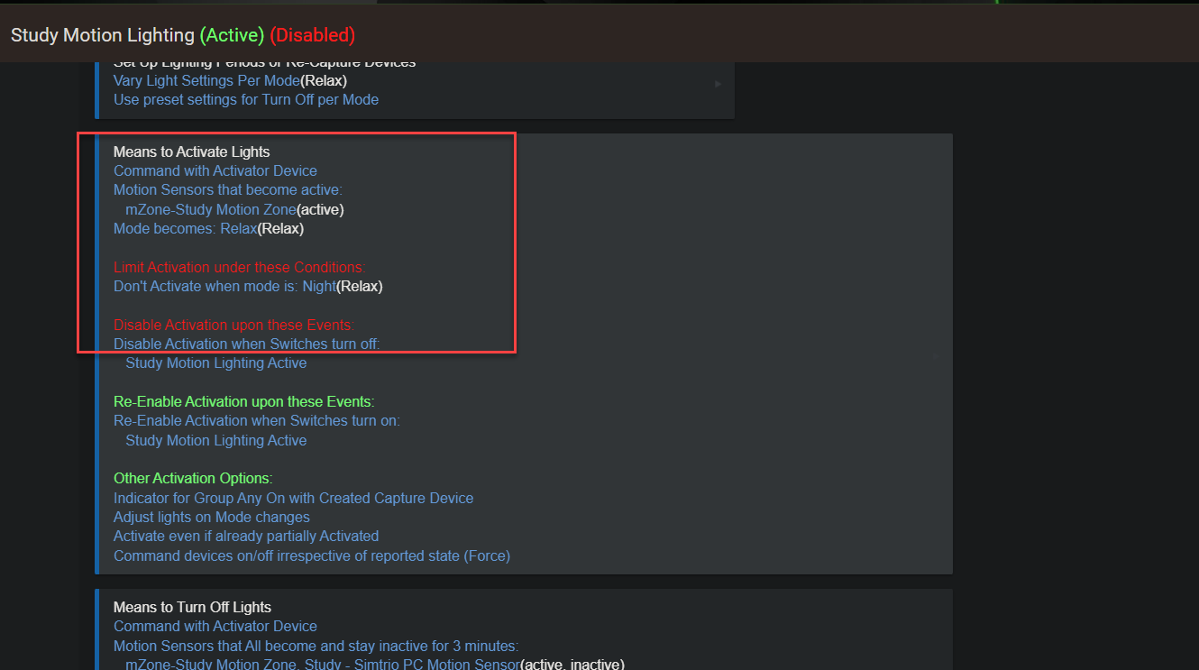

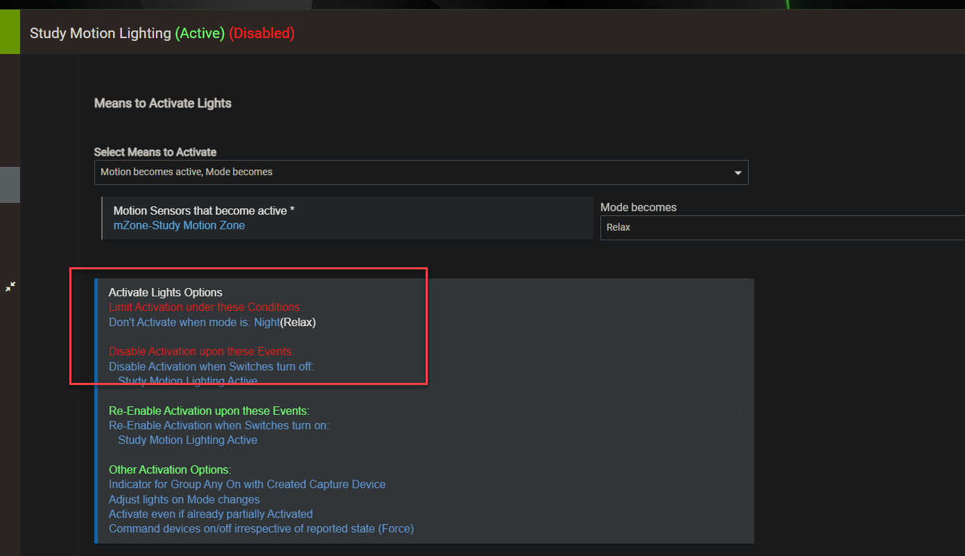

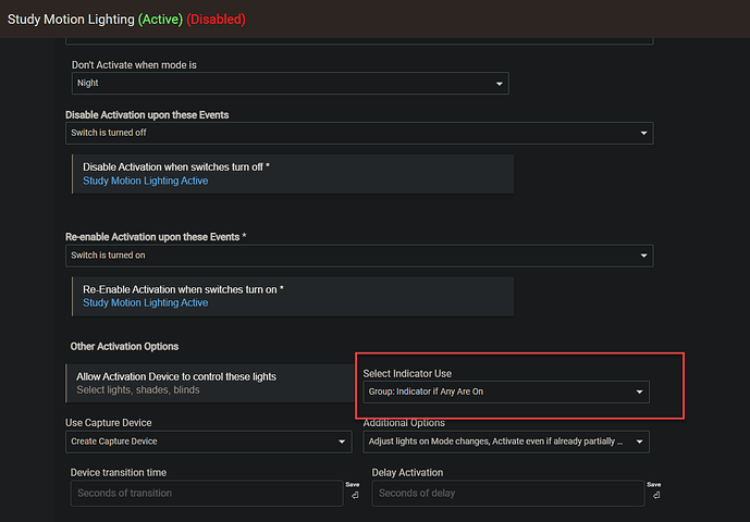

I suspect what you need to look at is this option under the Activation section:

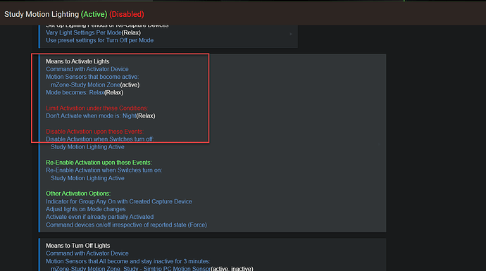

To get here, click on Means to Activate:
Activate Lights Options:
Ideally I'd like to this to behave as a scene. If the lights are set based on the table, switch is ON and I can turn OFF. If not, switch is OFF and I can turn it ON to get everything to table settings. The issue is that even when everything is set to the table settings, the switch is OFF and I can't turn the lights OFF, they also don't change when changing through modes.

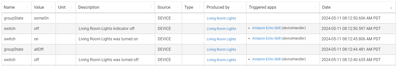

Edit: the behavior persists even with "Group: Indicator if any are on", logs from activator device:
logs from online device supposed to be on:
activation table:
Then I suspect you want this option, "All Set Per Table...."
Using "If Any are On" and it not working is odd...
"If any are on" works
But based on the docs, it seems to me that the app isn't working as expected for "only if some are on" and "all set per table"...but I can't seem to find anyone else with similar behavior.

It is odd.... It might be worth:
  • Posting a full screenshot(s) of the RL setup
  • Turning on debug logging for the RL App
  • Posting screenshots for the RL App

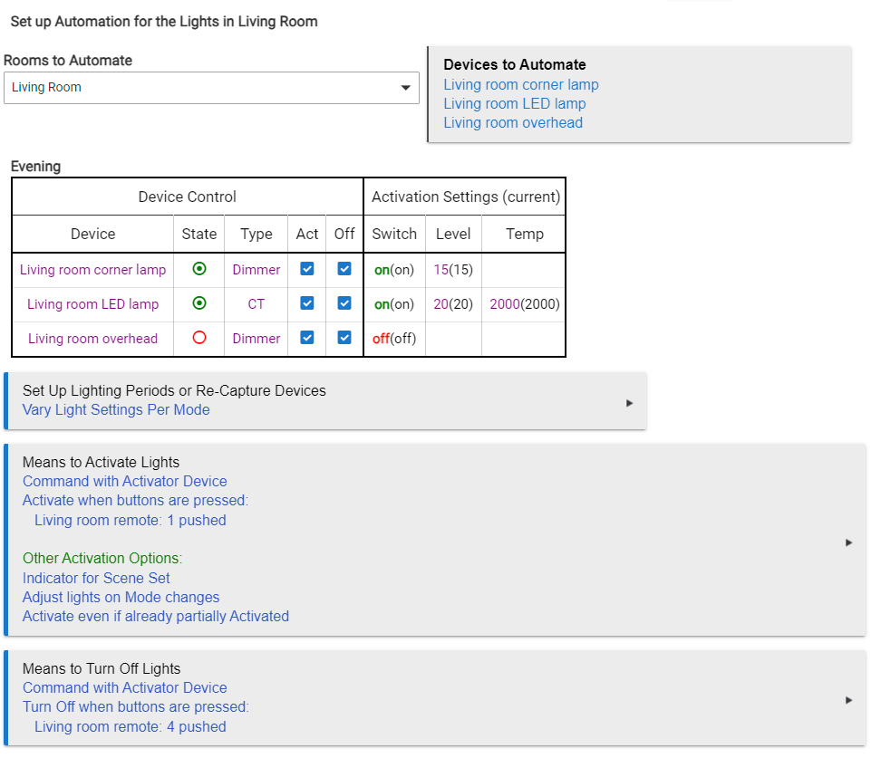

Missed this message, here are the details you asked for:
Thanks, @JB10 is likely on the right track... as much as the info I asked for is important, that is likely the path to pursue....
