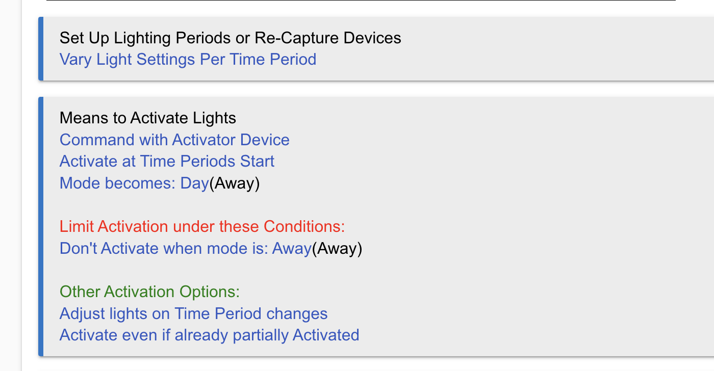

I have a room lighting setup with a restriction set not to activate when mode is 'Away'. The restriction fails and the lights activate by time period anyway. I can't seem to figure out what is wrong in my setup :

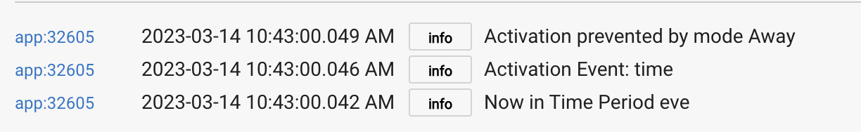

A debug log appears mentioning "Activation prevented by mode Away" but as the previous log entries attest (and the individual device status confirms), activation has already happened... Interestingly, "Activation event: time" appears twice in that log sequence.

I removed the "Adjust lights on Time Period changes" option and just tested that the restriction works now. TBH I don't even know why I had that option checked, I think it's leftovers from when I didn't really understand the "activation" concept.
I went back and checked the "Adjust lights on Time Period changes" again, and sure enough:

In all three sequences above, the initial conditions are the same : time period is 'Day', mode is 'Away' and the lights are turned off. When the time for period 'Evening' is reached, the restriction is only ignored if the option to "Adjust lights on Time Period changes" is checked.
I am not sure what this "Adjust lights on Time Period changes" option is supposed to do - is it for dimmers or colored bulbs that might be "activated" (already turned on) but perhaps not currently set at the same level/color as specified in the app? In my case, I only have simple switches so if my understanding is correct, it makes sense that I can do without that option.

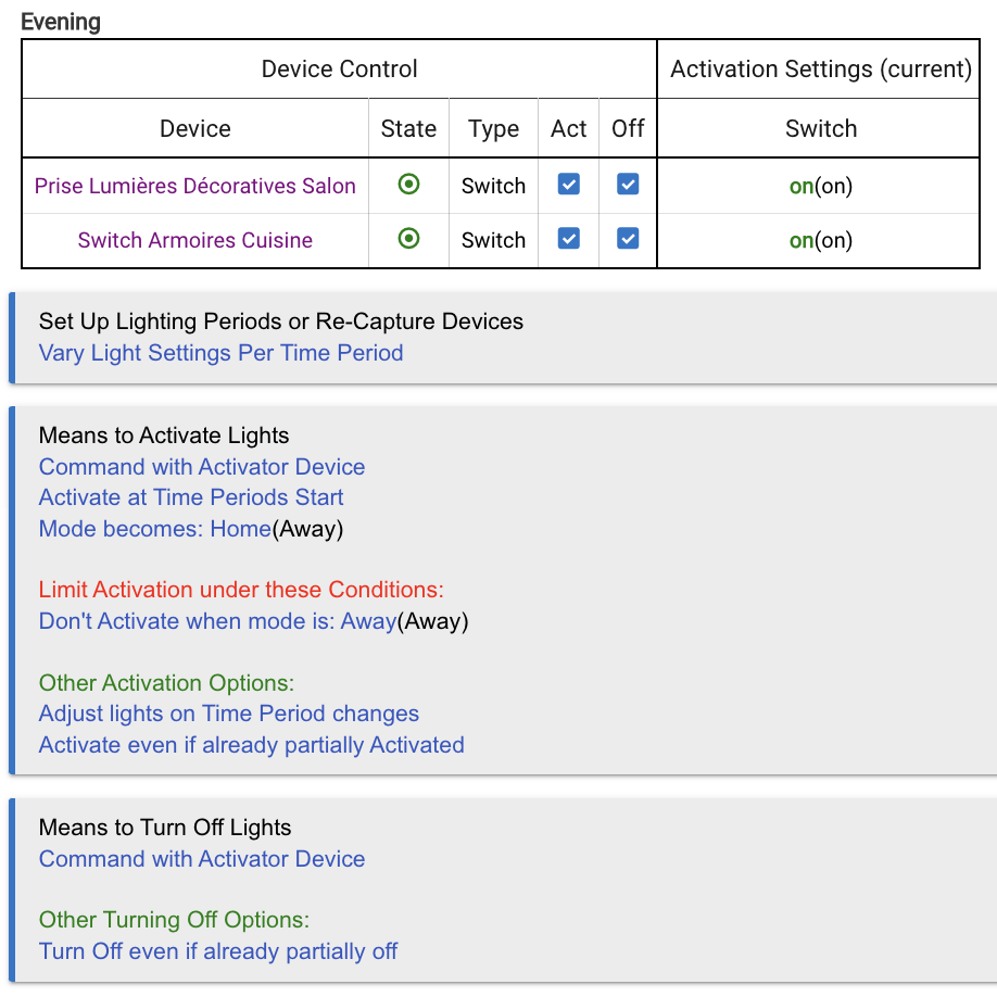

I have replicated your RL setup, and it doesn't fail for me. My logs are like this:
And the setup is this:
If the lights are already on when the time period changes, it will adjust them to the new time period settings. But it's pointless with the Means to Activate of 'Activate at Time Periods Start', since it is redundant.
