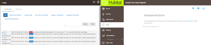

A few days after upgrading to 2.2.8.141 - I suddenly saw this error message (below) when trying to open up ANY of the rules I created in RM5!
I was also fooling around with Hub Variables prior to seeing this error.
An unexpected error has occurred trying to load the app.
Check Logs for more information.
Error: For input string: "0.1"
I am not sure where to start!
Please do this with a Logs tab open, and take a screenshot of the Logs when the error is thrown. Open which app specifically? One of the Rules or the Rule Machine parent app?
I can pick ANY of the new rules I created in RM5 and it will throw this error.

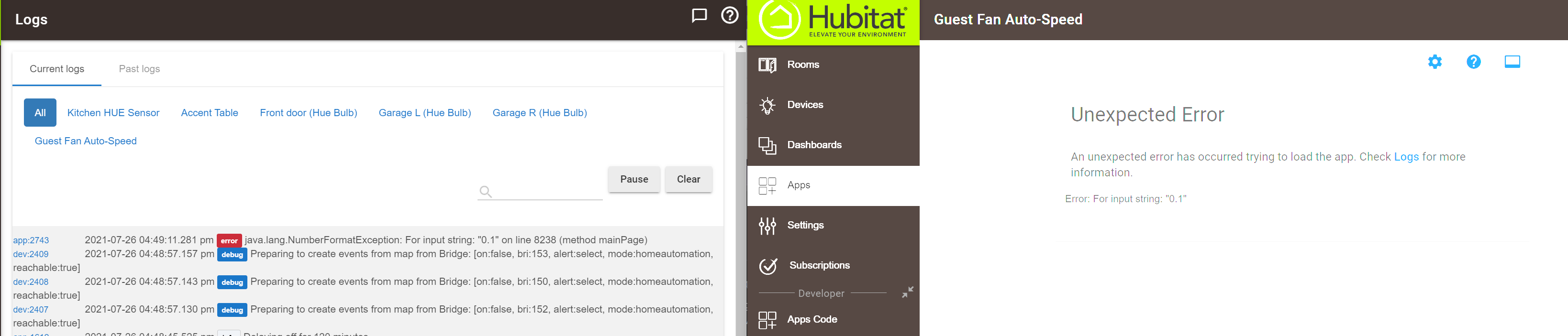

If I try to create a new RM5 rule - I get this error...
Also - When I go into settings / Hub Variables I get this error:
app:27402021-07-26 05:17:00.147 pm errorjava.lang.NumberFormatException: For input string: "0.1" on line 313 (method hubVar)

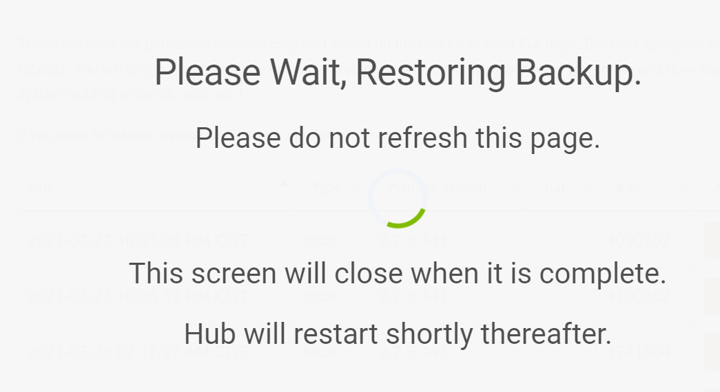

I am restoring one from early this morning at it just endlessly shows this screen!
How large is your database? I don't mean an actual number, just large, small, medium? Lots of apps and devices?
I meshed it with another Hubitat in the house which has maybe ~150 devices
otherwise this hub may have ~ 5 virtual devices/15 rules
Open another browser tab to it. See what's going on. Perhaps reboot it.
new browser tab was unresponsive - rebooted and it seems like the restore from backup worked!
