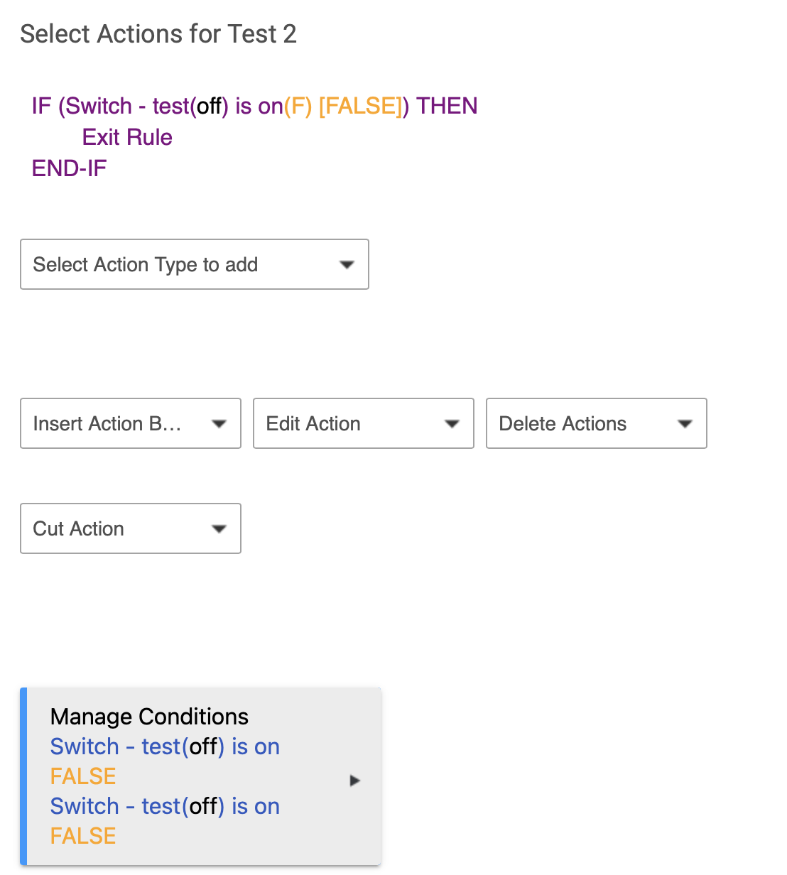

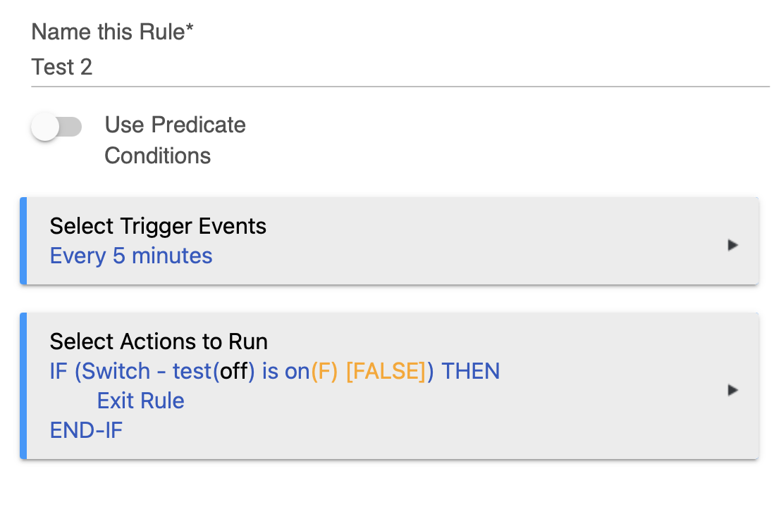

This is a simple rule with no predicate. It runs every 5 minutes and has an IF statement. (Yes, I know it makes no sense logically... this is just an example.)
This rule originally had the IF statement as a predicate. You can see in the conditions that there are two conditions that are the same. I assume one is from the predicate and one from the IF.

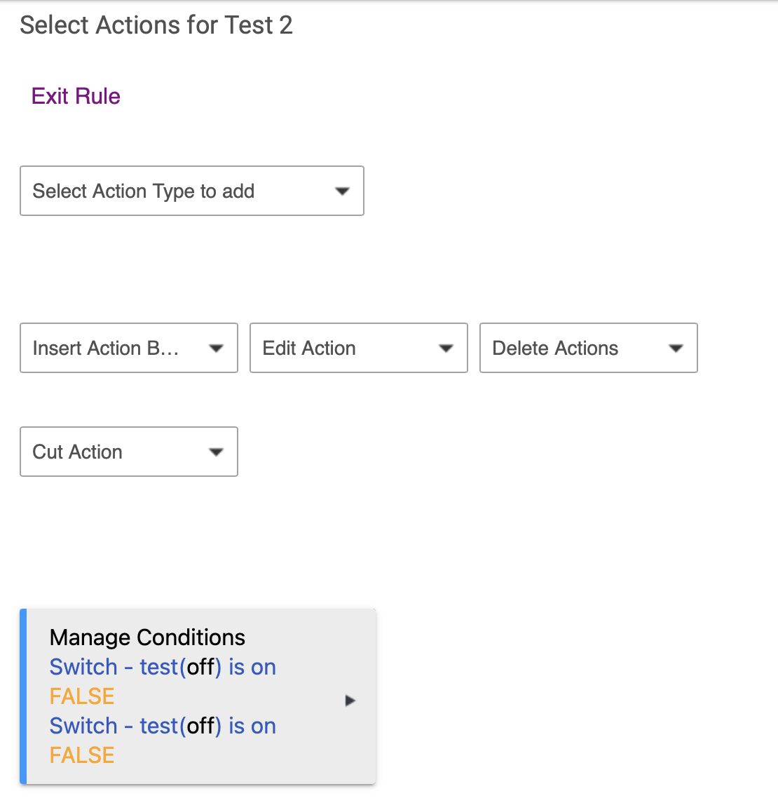

Then I went into Actions and deleted first the END-IF, and then the IF. Note that both of the conditions are still listed under "Manage Conditions."

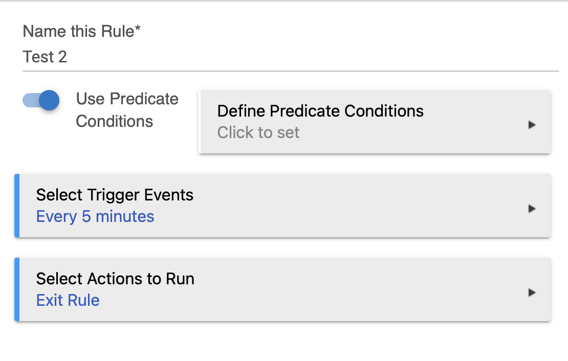

But now the Predicate has disappeared.

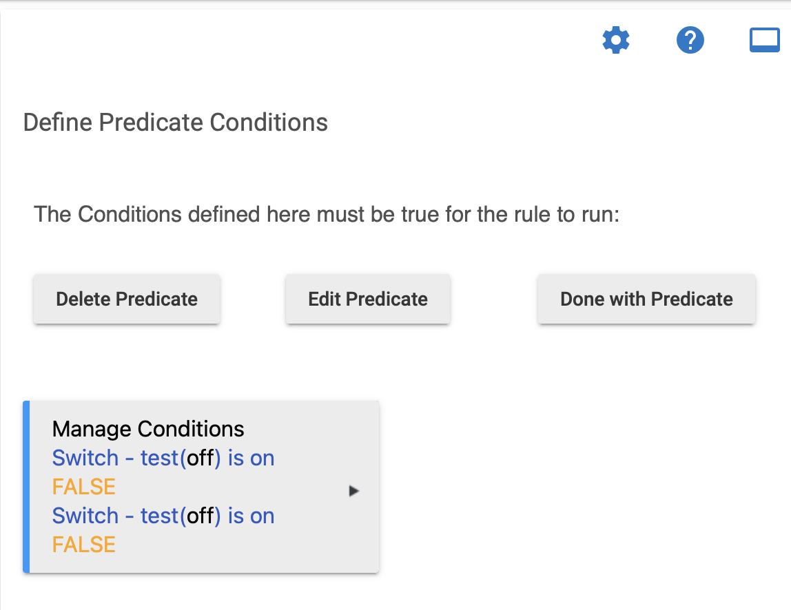

If I click the Define Predicate Conditions box, the only options are Delete, Edit, and Done.
