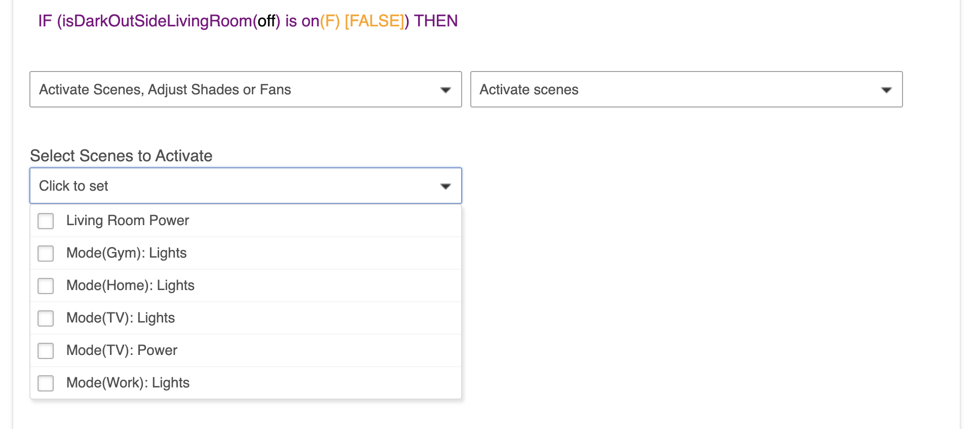

I having an issue where not all scenes are showing in 'Activate Scene' or 'Activate Scene Per Mode'

    Now I cannot see 'Living Room Lights'.
    I can work around this. Just thought it was worth reporting.

I have finally found the steps that cause the issue.
  1. Clone a scene.
  2. Rename the copy
  3. Check the scene is available in RM
It's not just a list issue, the scene disappears from the activate scene actions.
As you stated clicking done on the missing scene does add it back.
Please see if clicking Done in the parent app, Groups and Scenes, brings it back or not.
It does not, only clicking done on the missing scene works.
Its the renaming of the clone that causes the issue so there would still be an extra step after renaming.

The cloned/renamed theme shows up fine.
It's the original that has the issue once the clone had been renamed, and reopening the original and clicking done does solve the issue. Clicking done on the cloned/renamed scene has no effect on the missing original scene.
