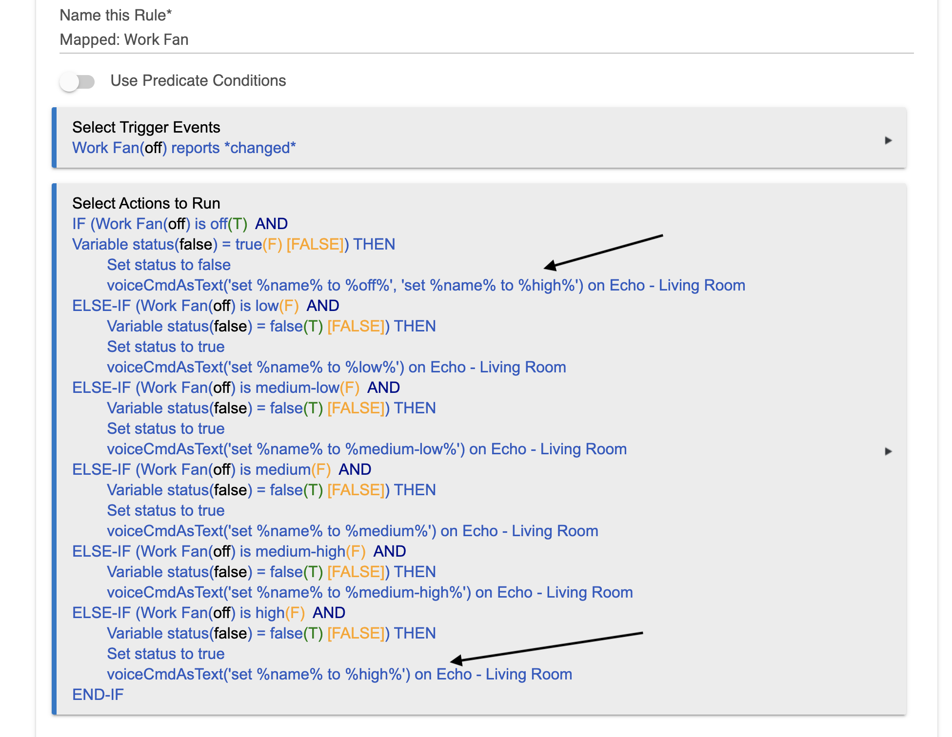

Here is a rule I am writing to map a virtual fan onto a real fan using Ech0Speaks.
The issue is when I get to the last custom action it adds the parameters to the first action. At first, I thought I had messed up somehow so I delete the extra parameter from the first action, this also removed it from the last action. I repeated a number of times to confirm the issue.
I will take a look. If need be as a work-around you could put the last action in a separate rule, and run that rule as the action in this rule.
I can see what is causing this bug. There will be a fix for this in the 2.2.9 release.
