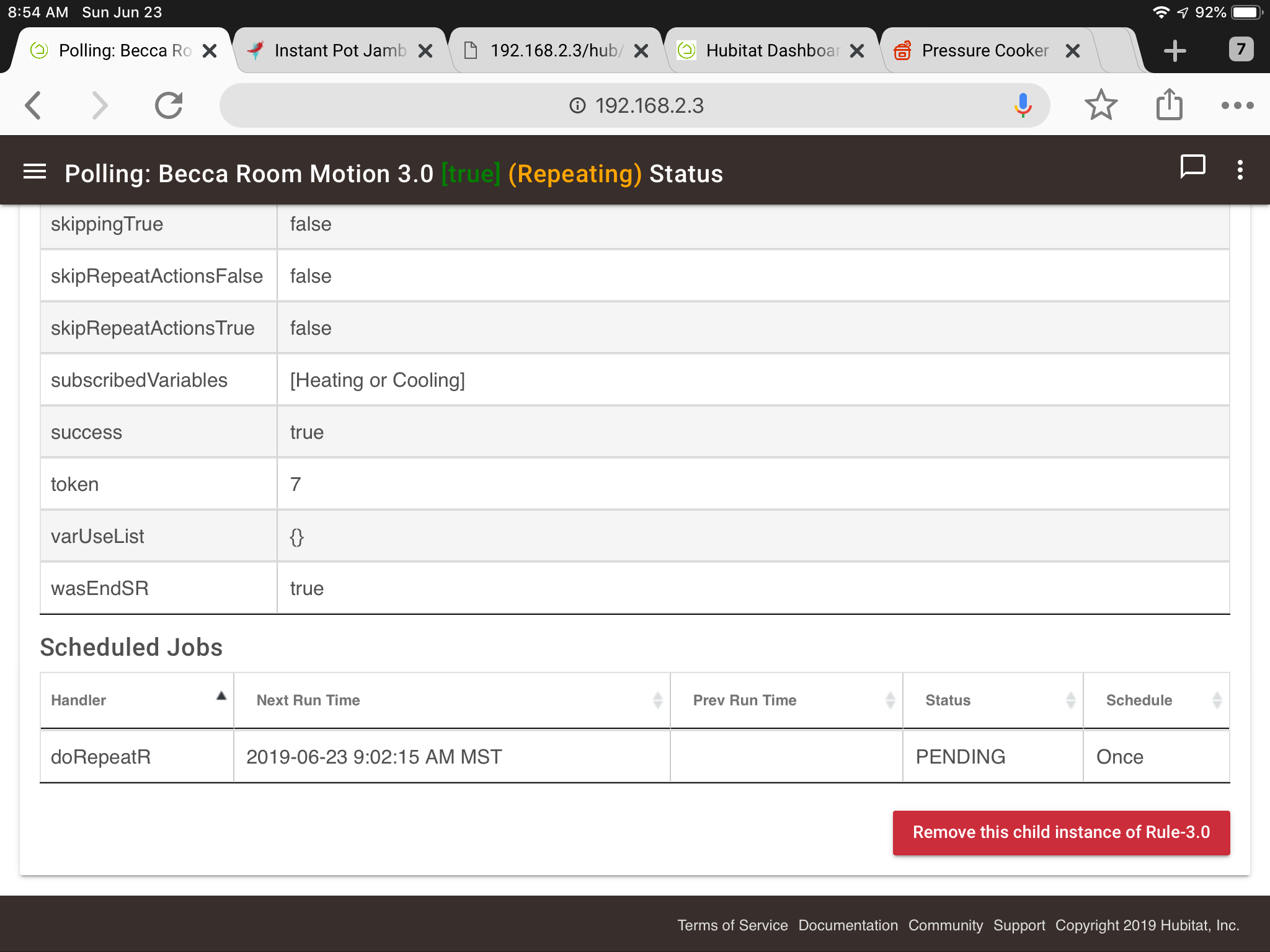

Check the future schedule on the setting page, little gear icon.
See if it goes to next Run time being 30 min.
