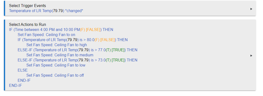

ok, been playing around and not having very much luck. This is what the rule shows right now:
IF (Time between 10:00 AM and 10:00 PM(T) [TRUE]) THEN
Set Fan Speed: Ceiling Fan to on
IF (Temperature of LR Temp(80.79) is > 80.0(T) [TRUE]) THEN
Set Fan Speed: Ceiling Fan to high
ELSE-IF (Temperature of LR Temp(80.79) is > 77.0(T) [TRUE]) THEN
Set Fan Speed: Ceiling Fan to medium
ELSE-IF (Temperature of LR Temp(80.79) is > 74.0(T) [TRUE]) THEN
Set Fan Speed: Ceiling Fan to low
ELSE
Set Fan Speed: Ceiling Fan to off
END-IF
END-IF
If I read this correctly, the fan should be on high speed, correct?

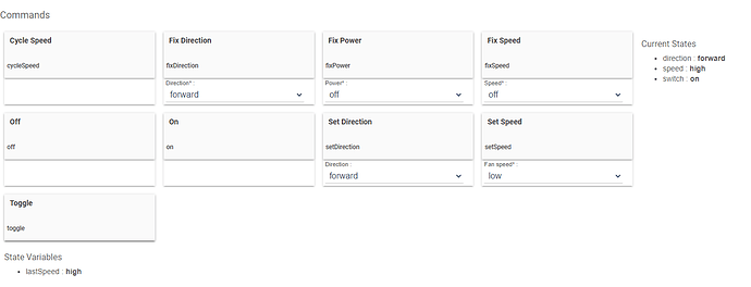

Per the device, it is on high speed, yet the fan is running at the speed it was turned off on last night which is medium.
In the rule, if I push "run actions", the fan goes to where it needs to be running, which right now, is high speed.
I am testing right now if the fan will slow down if the temp gets below 80. Should know that in 45 min... EDIT, the fan did speed down as it is supposed to do.
Question is, why do I have to hit "run actions" to get it to start running at the right speed for the temperature?
There's a chance the temperature reading may have dropped shortly after you opened the rule. Try checking the event history for the fan and/or turning on logging for the rule to see what is happening
maybe put a delay after the on? it might be turning on then sending the high command too fast, so the fan doesn't process it
-->**DELAY 2 SECONDS**
ELSE
END-IF
END-IF
good call. I put in a 2 min delay to see if that works.
I will keep an eye on the logs and see what I can get from them, thanks, but I don't think the temp dropped...
pretty sure you don't need to explicitly send the on command either, it will turn the fan on with the appropriate speed when it receives that command. you could also try to remove that on command and just let the nested if statements handle turning it on
I second @dadarkgtprince, if the fan is already "off" then setting the fan speed will automatically turn it on. You should be able to eliminate both the "on" and the 2 second delay you have at the start with that change!

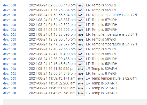

Depending on how many rules/devices you have my only question is: How often does your temperature sensor report new temp values?
I only ask because some temp sensors report back every 30 seconds by default which means (on top of whatever else you may have your hub doing) it could be running and re-running this entire rule/logic a LOT in those 12 hours between 10 and 10.
Don't worry, you'll probably be fine but just wanted to point it out in the rare event you were not aware or if you see any slowdowns later on.

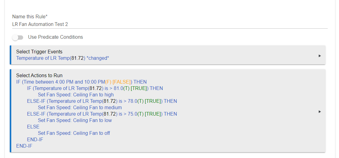

thank you for the suggestions. I have rebuilt this to the following pic.
Here are the logs for the temp sensor, showing it does not look to be every 30 seconds.
