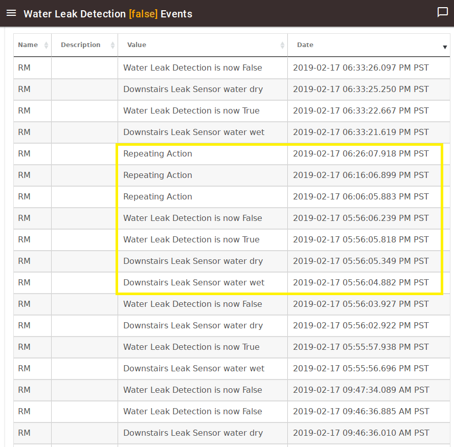

Here is the events page from the leak sensor. The RM app went to the incorrect state around 5:56:05 after several rapid state transitions in the sensor state. I could restore the app to the correct state at 06:33:25 by creating a single wet / dry transition.

Point taken about events that are too close together being missed or being received out of order, and ending up in the wrong state as a result. But in this case I see the events made it into Rule Machine in the correct order (see snapshot below).
I could put in the 10 seconds delay as you suggest, with cancel on truth change. But RM seems to be ignoring the stop on truth change in the current set-up -- so I imagine it will also ignore the cancel on truth change.

Here is a snapshot from the rule's events page. It shows that the last event at 05:56:05 was "water dry", and the rule correctly transitioned into the False state at 05:56:06. But it continued with the repeating action.
