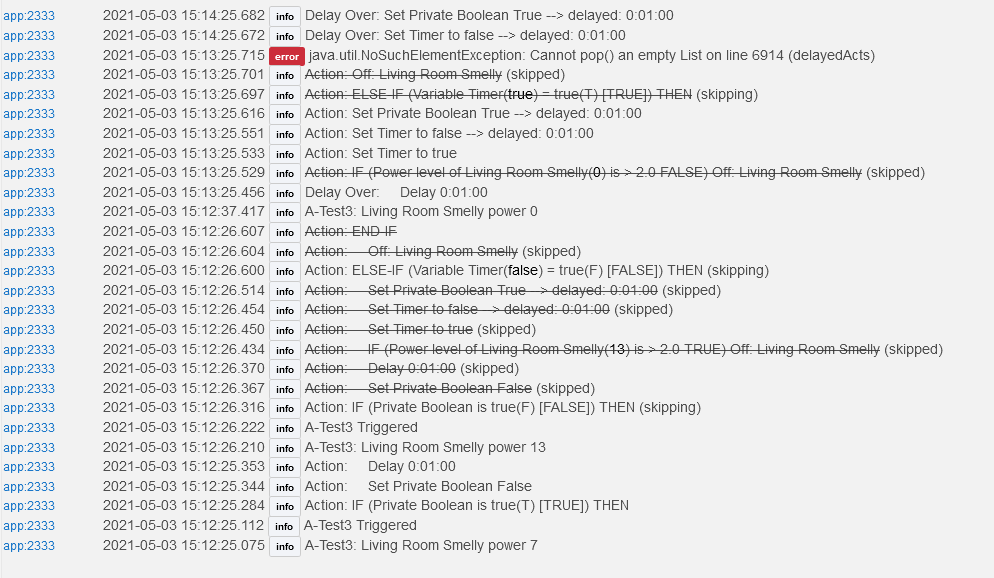

@pseudonym It actually looks like it is working which is great! The only thing I see is this error, not sure why it is throwing this error. The times and device is temporary to test with until it works 100% then I will put the correct device and times in.
I believe a pop() error indicates an issue with multiple instances of the rule running simultaneously. You can see the rule is triggered when the power is 7 and again when the power is 13. I need to look at it more to see why it's identifying delayedActs.

Yes, the same error came up.
@jonathanm8 I don't see how the rule is colliding here. Try the Run Actions button to run only one instance and see if it's still happening.
Looks like the error didn't come up this time with running it on the run actions button.
