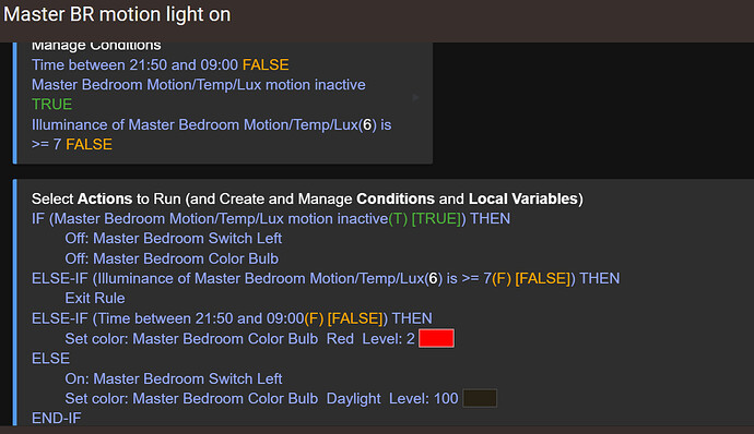

On 2.3.9 (currently on .150 on a C4) when an RM set color command executes and the existing bulb color is not the requested color, the color changes but the level does not change. However on subsequent exeutions the level is correct. This worked on 2.3.8 and prior versions, although the bulb would first turn on with the the existing color and level before quickly changing to the requested color and level.
Bulb: Sengled Element Color Plus
Driver: Advanced Zigbee RGB Bulb
Any suggestions or workarounds appreciated.

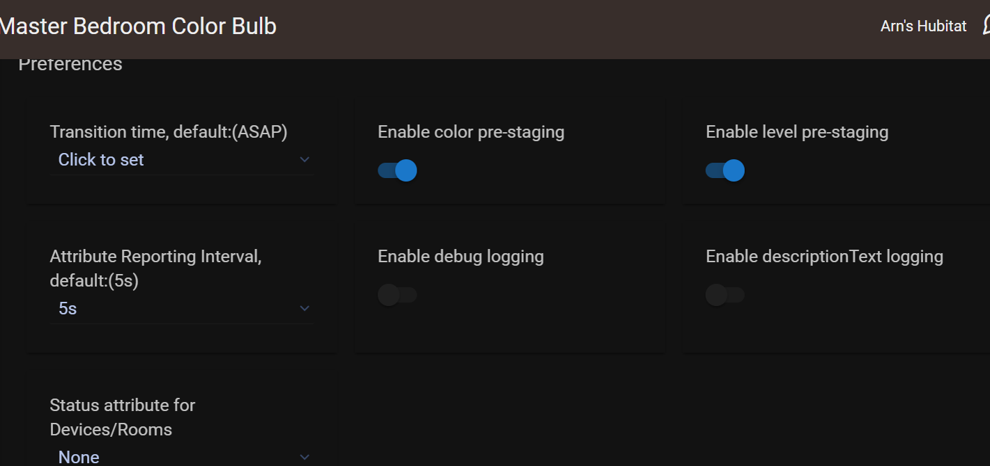

It should turn on. Do you have any of the "pre-staging" options enabled? That will make it need a separate "On" command (and is not something I'd recommend unless you know all the implications of enabling it).
Whatever was set for the driver is what I used, and yes Prestaging is set On explaining the need for the On command.
