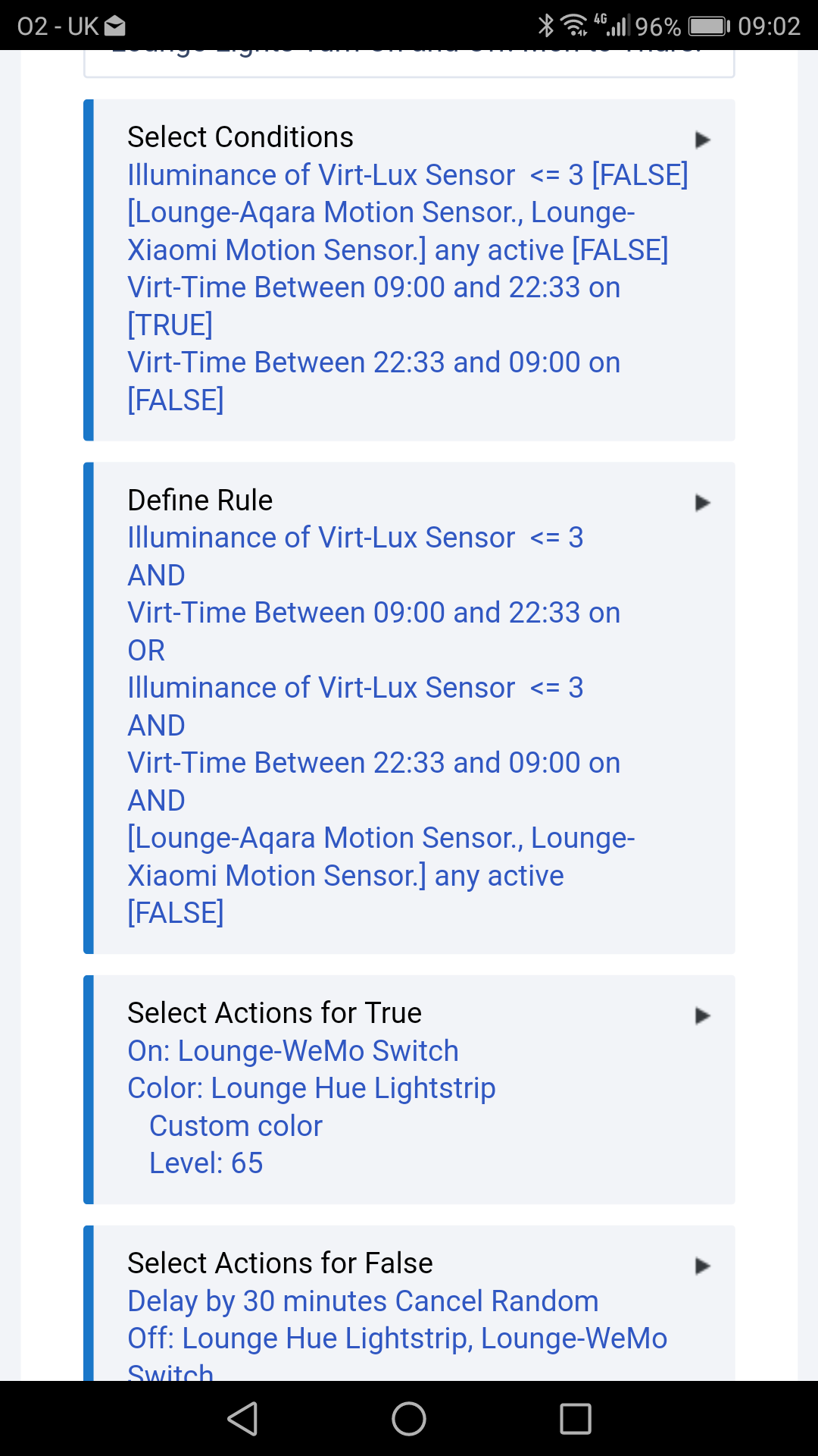

@bravenel I need some clarification on this please.
In a post above you suggested that I could use-
A and B or D in an expression for a rule.
I have interpreted this to mean
A and B to be true
OR
C to be true for a rule to become true,
In the rule below this is not happening.
When the Fan is on (true) and A and B are false, the rule does not become true
I may have misinterpreted you answer and thats why I'm after clarification.
Thanks.

The rule in post 11 is working as you suggest it should use AND AND AND OR AND AND (both groups of ANDs work independently of each other) which has solved my original problem. Still cannot work out why the rule in this post does not work OK.
The clarification is that the rule is evaluated without any operator precedence, from left to right. So I was wrong before in suggesting to not use parens, because if the second operand is false, it will blow out of the evaluation at that point.
So it does need parens: A AND (B OR C) or (B OR C) AND A
