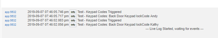

This logs correctly (I entered a code twice):

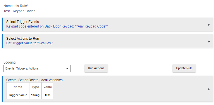

Then I modify the rule with a local variable:
It still works correctly (I entered a code 3 times):
