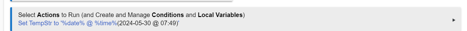

Create a hub string variable and fill it with %time% and %date%

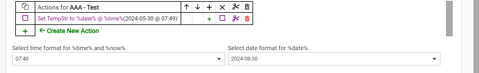

How do I show AM or PM?
In the RM editor where you set the action, there should be a area that lets you set the format of your time and date.
I missed that detail originally, thank you sir
