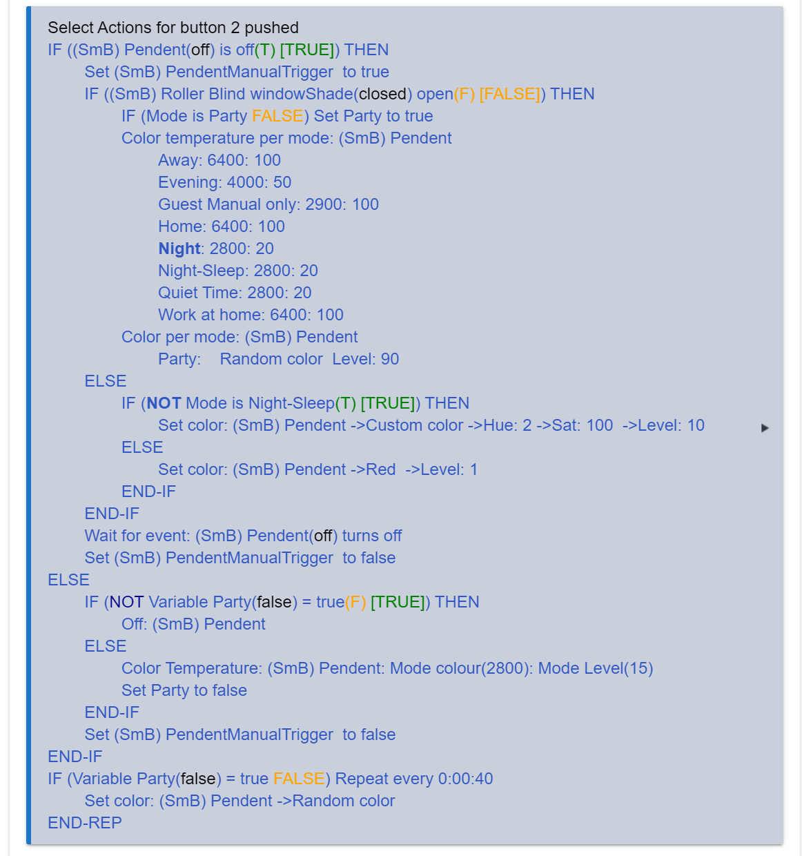

Just dream up what's ever I want and do it :slight_smile: . IE
I also have a young one and when she was born I was determined to that we would do everything we could to make sure she was a good sleeper. We have a RGBW lamp as her pendent in her room and when it was bed time I wanted the light to be red. This would help with setting up her natural rhythm that baby's basically don't have. I also wanted black out blinds and for all things to be automated. So when I did her room I fitted what I needed, then did this.
