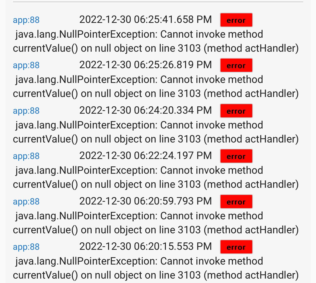

Rule machine error on my table lamp app. Any idea what is happening here? Do I need to remove it and recreate it?
Tagging @bravenel
What is your "table lamp app"? It seems as though there is a missing device. Can you show the rule? If not, then yeah, remove it and recreate it.
Yeah we can disregard. Its a rule machine rule I created for my table lamp that was tied to a Aeotec MultiSensor that I must have forgot to remove from the rule and then had to remove as a ghost ZWave device. I added a new MultiSensor after getting it replaced under warranty and added it to the rule and then the error started happening. I just deleted the rule and recreated it and now itβs working fine.
