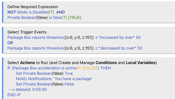

I'm receiving invalid operand type using increased by over and decreased by over in RM from a 3-axis sensor using the default/system SmartThings Multipurpose Sensor V5 on C7 running 2.5.0.136. Last post with this error @bravenel got involved. Let me know if i forgot to include anything.
Rule:
Logs:
app:18682026-05-19 06:07:19.119 PMerrorinvalid operand type for 151(number) *increased by over* 50(number, error=java.lang.NumberFormatException: Character [ is neither a decimal digit number, decimal point, nor "e" notation exponential mark.)
app:18682026-05-19 06:07:19.105 PMerrorinvalid operand type for 151(number) *decreased by over* 50(number, error=java.lang.NumberFormatException: Character [ is neither a decimal digit number, decimal point, nor "e" notation exponential mark.)
app:18682026-05-19 06:07:19.094 PMinfoEvent: Package Box threeAxis [x:0,y:0,z:151]

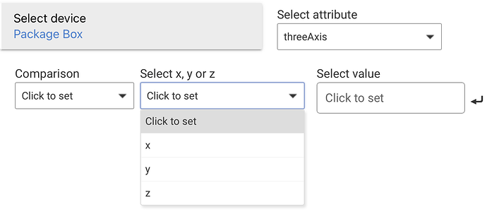

Things may have changed. If this were still the case i would not expect the UI to have an option to specify which key from the map. This looks like it's been designed to expect a map... at least from the UI.
