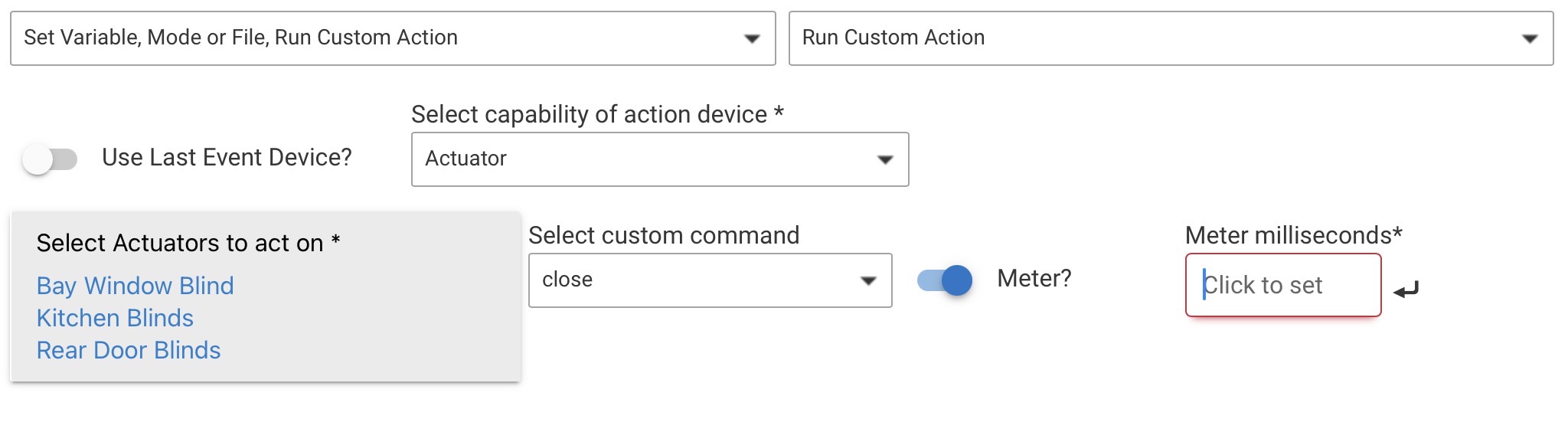

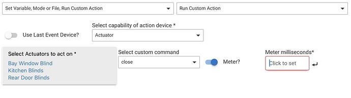

I can easily put each blind on a different line in RM and then put a small delay between each and everything works great.
Is there some way I can just list all five on a line and add a delay that is between each…instead of the RM delay option that delays when the whole line fires.

I believe with the Groups/Scenes app, there is an option to setup a delay between each device command - Know as the "Enable Metering" and the delay time is specified in ms - Downside is this App, just works for bulbs, switches, and dimmers (NOT shades). I believe the RoomLighting App CAN do metering for groups of shades, but I don't have an example of that handy.
I've asked to have Shades added to the Group/Scenes app, and have been told that this App is depreciated, and the "right answer" is to use the RL App, which can already support shades - Then within RM, just add a single line/command to effect the group, - and all the included devices are effected with the built in metering delay. So I think that's the recommended HE approach, to avoid dealing with this one device at a time in RM..

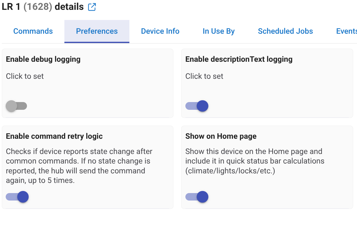

I have 18 Smartwings shades. Mostly ZigBee. Two rooms have 5 and 7 respectively. They usually all move together; however sometimes one or two will miss the initial command. On the shade device preference page there is an option for “Enable command retry logic.” It does exactly that. I believe for shades there is a 30 second delay to give shades the time to fully open or close before retrying. That works every time for me. It will retry up to five times.

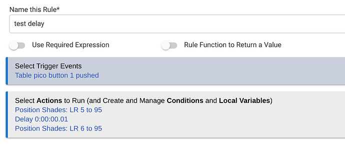

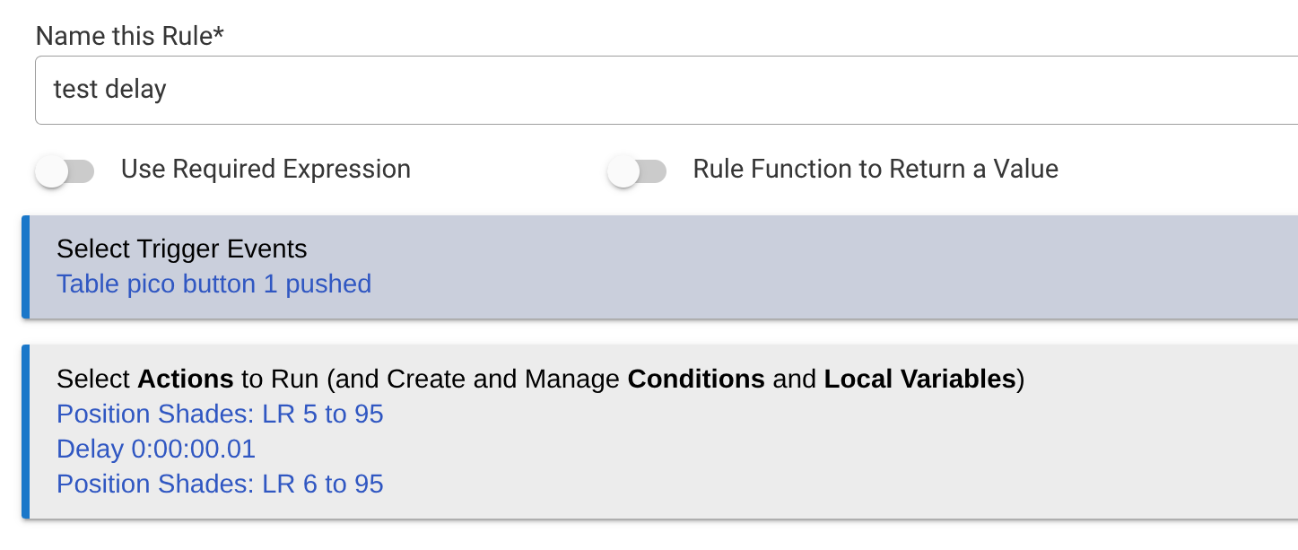

You can also do 0.01 second delay between shades which is invisible.

I think the hub has a practical limit as to how many simultaneous commands it can execute. Probably not device specific. Likely more an issue of what the ZigBee network can effectively communicate before it is “swamped.” The good news is that they are not lost, with command retry they do get through.
Spacing the commands by fractional seconds solves the problem and isn’t aesthetically noticeable.

Mine have a 1/2 second delay between them an they never miss. Can’t really even notice it unless you are REALLY focusing on it.
