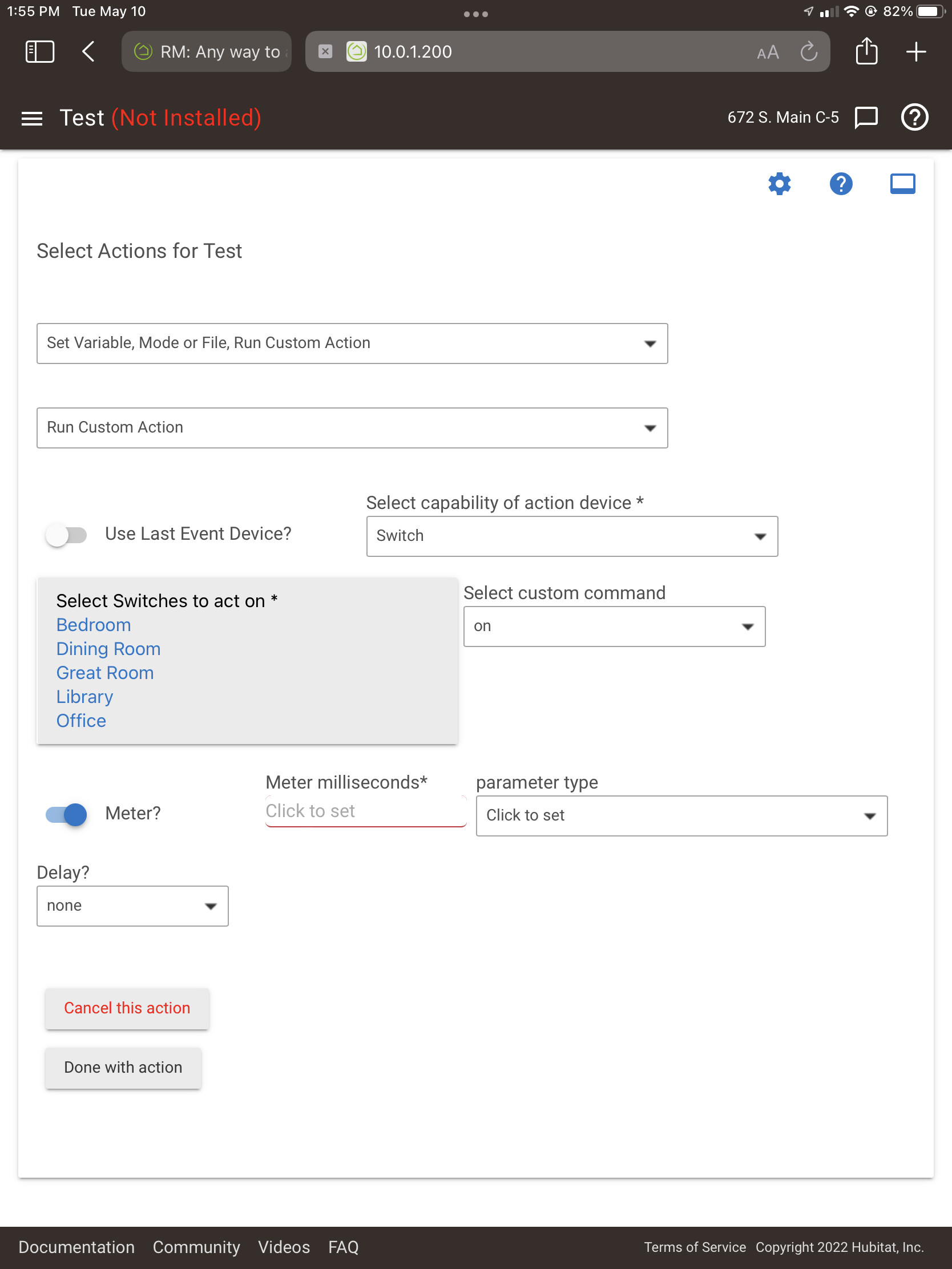

RM: Any way to add metering?
I have a rather simple rule that turns a bunch of switches on or off.
First question: If I list all the switches on one long line vs one switch on each line, is there any added delay?
Second Question: Is there any way to use metering in a rule? I know I can add a delay in 1 second increments but it appears it doesn't support milliseconds.
I'm just trying to troubleshoot an issue comparing a rule and group and ms delay would be handy.
There is no on-purpose delay if you do them all in one action vs multiple actions with one each, though I wouldn't be surprised if the latter takes maybe a few milliseconds longer in all given that it's just a bit more work for the rule (but this is not something I'd rely on). You could also manually insert delays in between that way, though that's probably not what I'd do.
For the second question: yes, you can use metering in rules. It is only available for custom actions. Thus, instead of using Control Switches, Push Buttons > Turn switches on/off, you'd use Set Variable, Mode or File, Run Custom Action > Run Custom Action, and use the on() or off() commands directly that way (you'll be asked to choose a capability first; anything the device supports will work, though "Switch" is a likely good candidate).

Use a custom action. Metering delays are in milliseconds:
