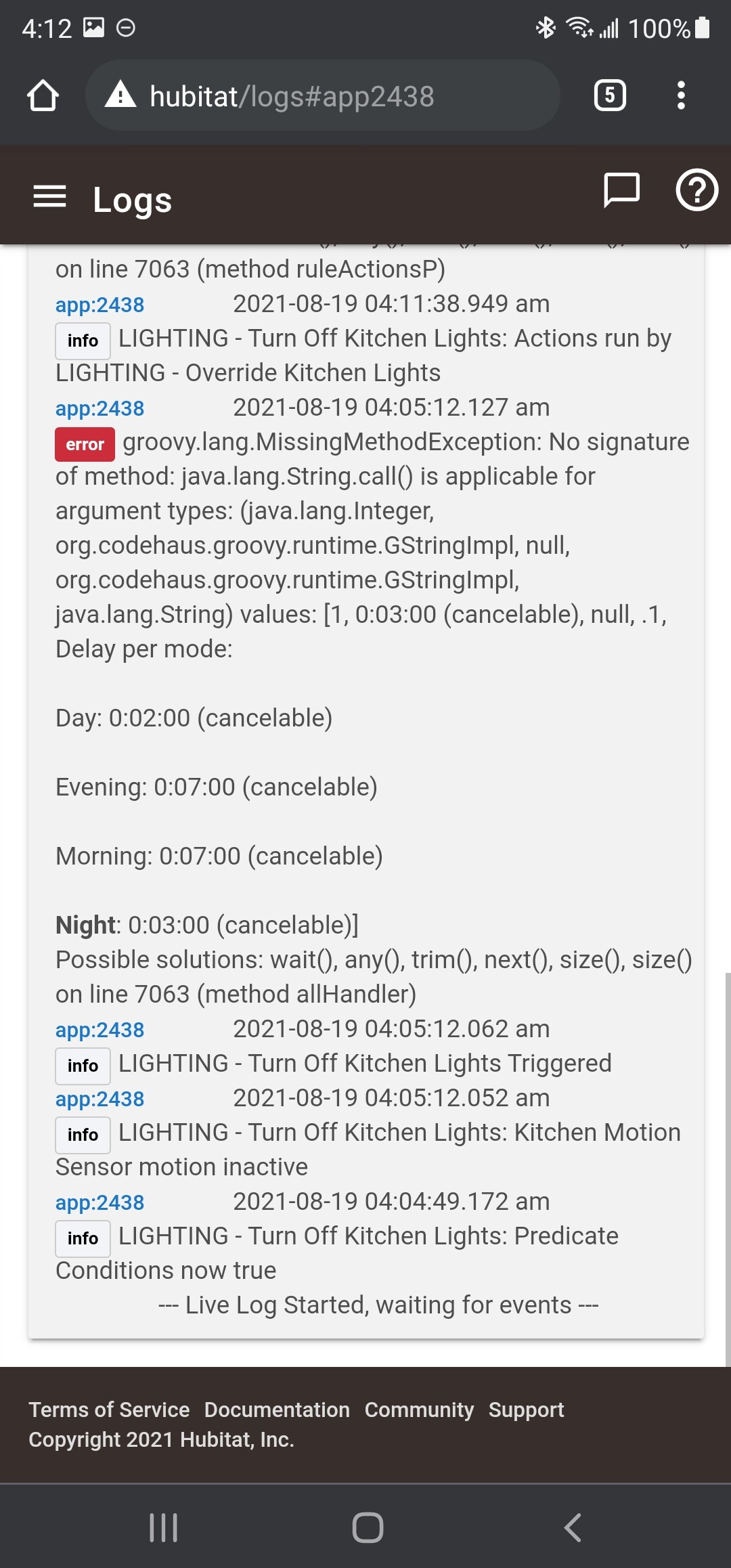

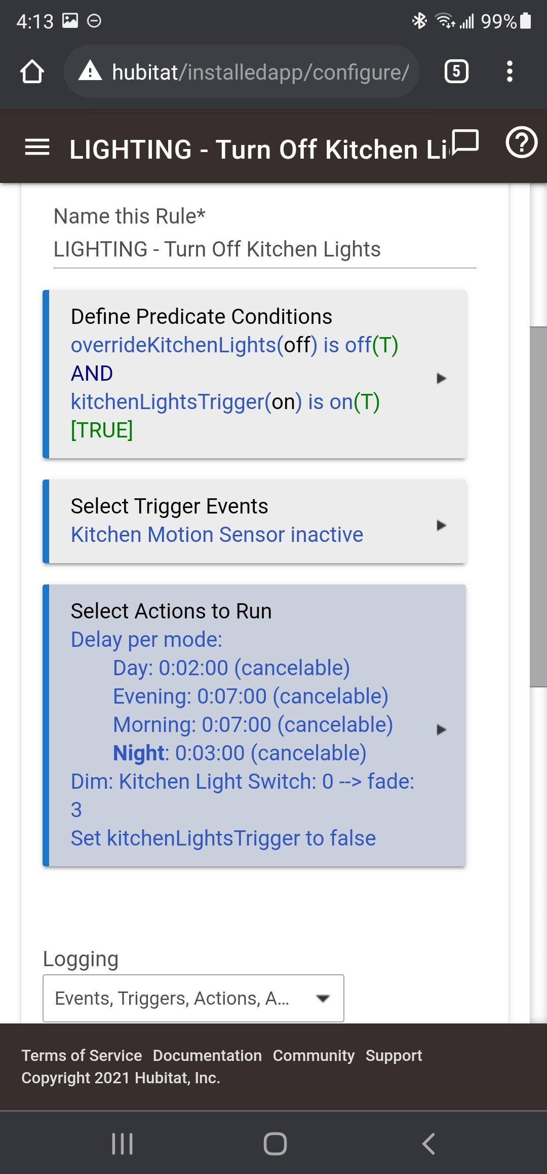

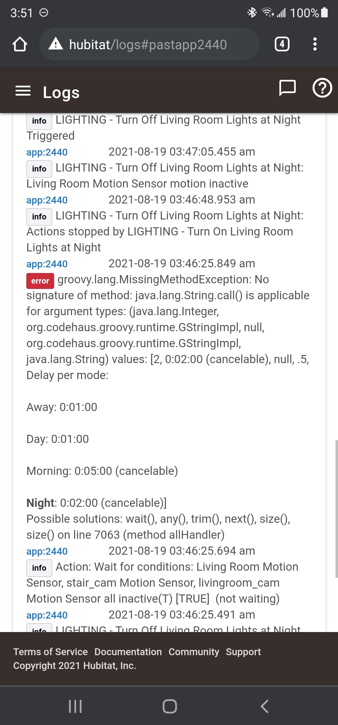

So I am getting errors in RM5 I didn't get in RM4 on any delay by mode. It is either causing a runaway rule or wreaking havoc on my lighting. Here is the rule and the related log...
I am not sure what I am doing wrong here in RM5 that is causing this behavior.
This same behavior is appearing on a similar rule resulting in execution halting.

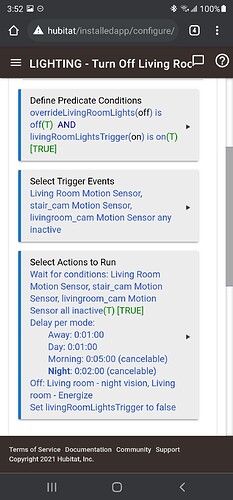

Why trigger on any one of the motion sensors becoming inactive and then wait for all of them to become inactive? Again, not a criticism, just wanting to know what you are trying to achieve. One option may be to use the Built-in Zone motion sensor app to group the sensors together under a single aggregated motion sensor.
The delays seem fine, is there any reason the Away and particularly the Day mode ones are not cancellable?
What is the idea behind the livingRoomLightsTrigger? Is that to indicate that the lights were triggered by motion so the rule to turn them off needs to act on motion becoming inactive?

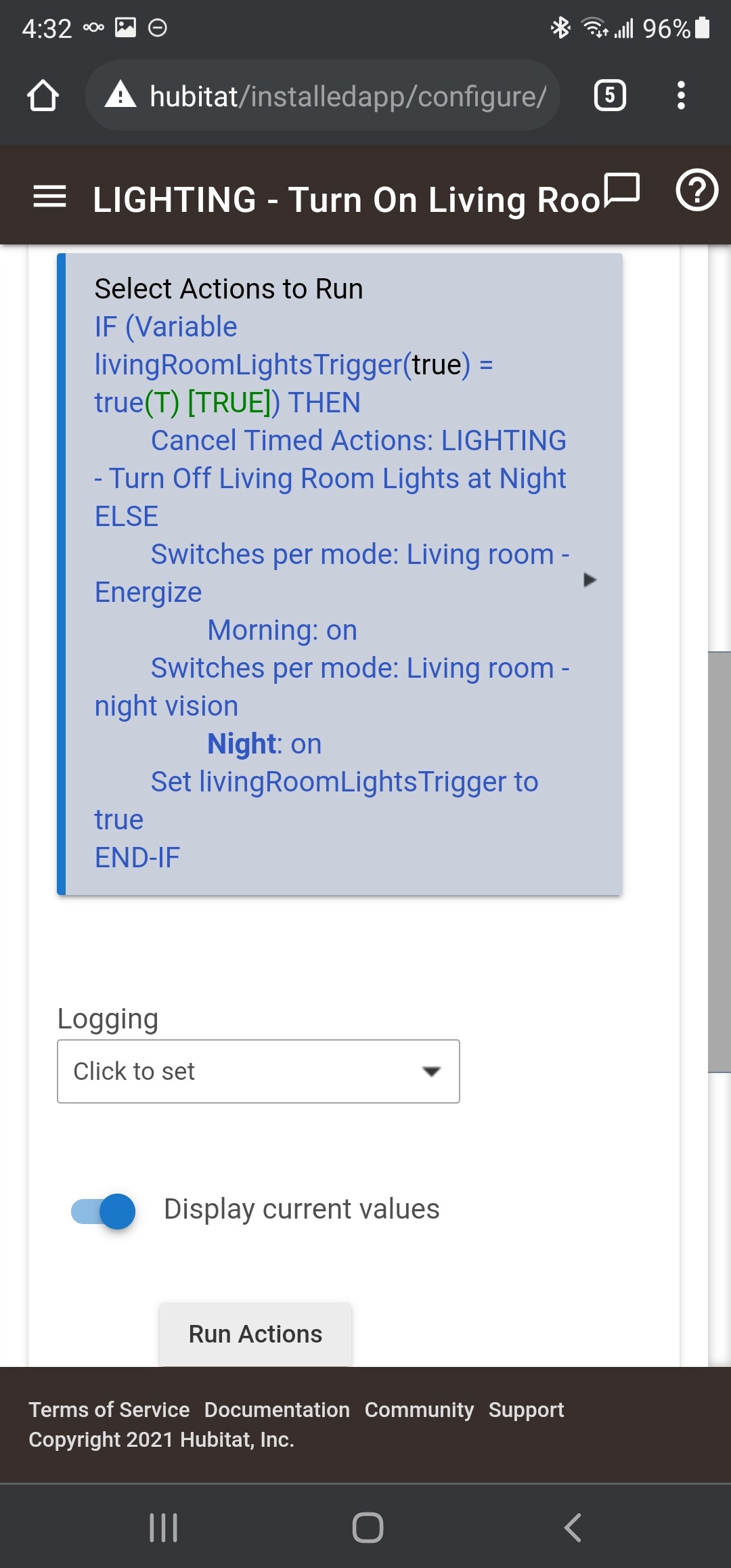

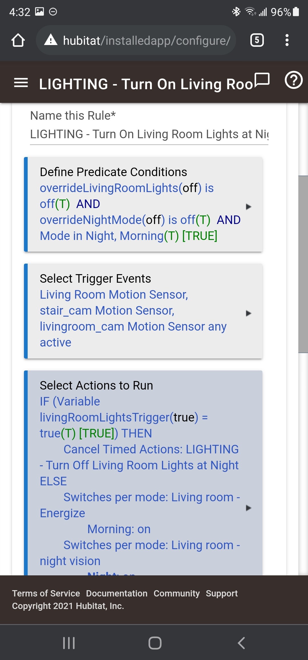

So the issue with the motion app is that I have multiple complicated scenarios and changes in scenes, etc. Furthermore I like to have everything in one place and not spread out amongst numerous apps making it hard to remember who and what is doing what. These rules worked fine in RM4 using conditional statements. I figured the predicates would actually save a minor amount of processing time by not evaluating the entire rule. Here is the sister rule to turn things on. Basically the rule turns on lights at night so I don't go bump in the night. It allows for me to override though if I have guests staying in areas that would trigger the rule... i.e. friends crashing on the couch at night etc. It also checks the mode to only run when night is triggered.
  1. Predicates must be met of mode and override switch being off
  2. Subscribed motion sensor is Triggered
  3. Lights set to red and dim set level
  4. Trigger variable set... similar to private boolean
Companion rule to turn off
  1. Predicates of override swith off and trigger truest be met
  2. Motion sensor inactive triggers rule
  3. Rule makes sure related motion sensors all go off before completing rule as that room has more than one sensor and it's a large room.
  4. Delay by mode then Triggered
  5. Lights dim off.
Again this all worked in RM4 no problem. I appreciate the suggestions of different apps but have tried them and thry just don't quite do what I need not to mention not germane here as the issue is why isn't RM handling this like it's supposed to? What has changed that is throwing the error? The on rule runs just fine;
I still wonder whether you should set the triggers in the off rule to be that ALL the motion sensors are off... rather than waiting for that in the rule? Maybe the rule is being triggered multiple times because of the trigger being any one of them becomes inactive...? Maybe that's the change in behaviour?
I also wonder whether the wait for inactivity at the start of the off rule needs to be cancellable? Not sure whether it can....

I still feel that the Zone Motion app would be a good addition to replace steps 3 and 4 in the rule to turn the lights off. I'm also wondering if that causes some of the problems, with different instances of the rule firing... I've never been quite sure how that all works, Bruce / HE staff would be the ones to answer that for sure.

@bravenel Bruce sir, do you happen to know what I am doing wrong here? It seems to be throwing this error on all my delays per mode. I deleted and rewrote the delay statement as @sburke781 suggested but I am still getting a Java error as soon as the rule executes. The rule then does not complete and seems to halt on the delay. I know for sure this is happening on one other rule... checking through my other ones now. Any help is appreciated.
It's probably a bug. I will investigate.
Ok thanks!
I tracked down this bug. From what I found, it only happens if you have Action Logging turned on. Fix will be in the next release.
Thanks. Your right that allowed it to run fine by turning off that logging.
