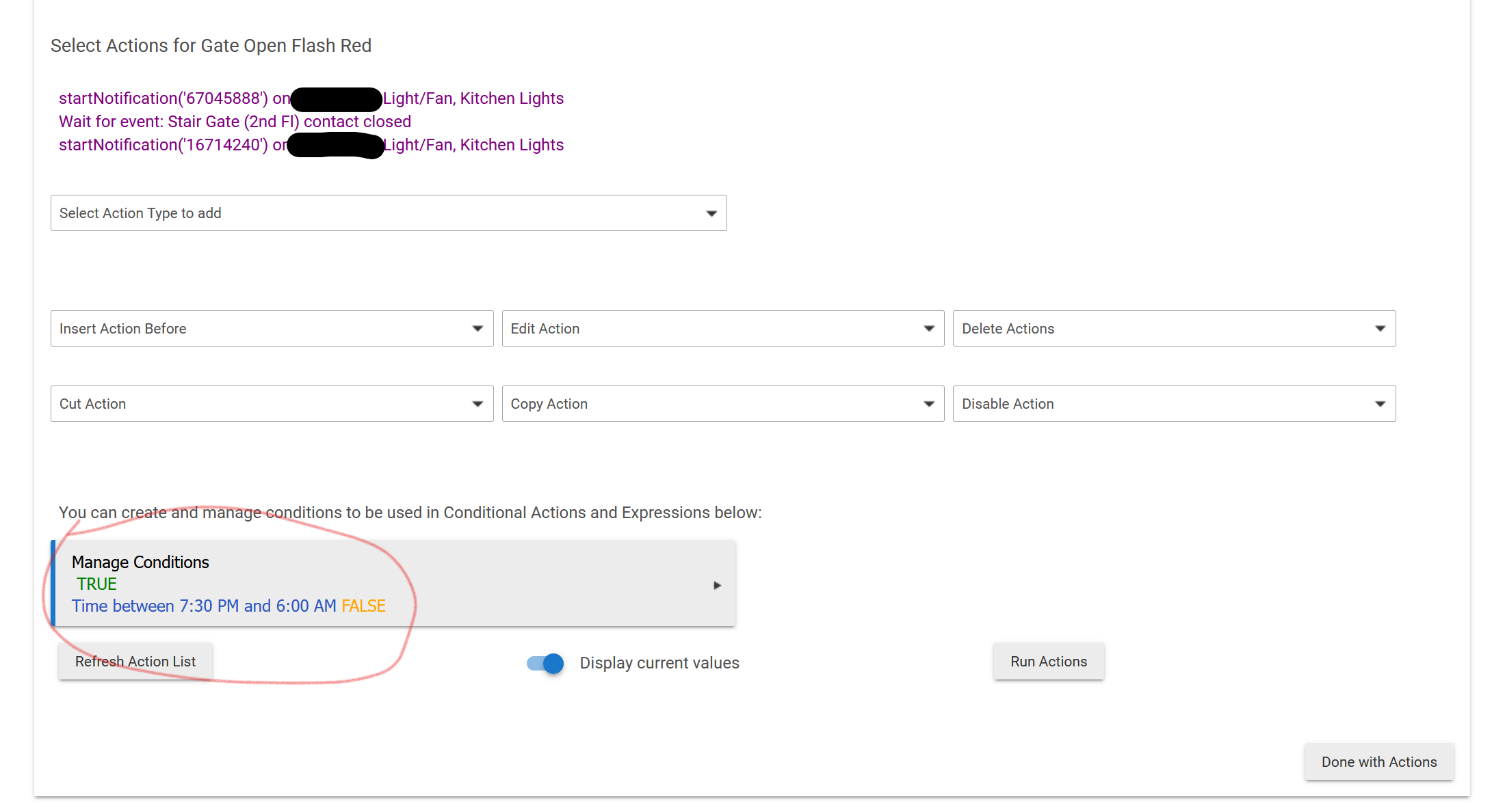

Quite possible I'm doing something wrong, but I can't seem to get RM 5.1 to respect "Time Between" conditions in a rule.
I'm just trying to have a rule that flashes my Inovelli Dimmer LED strip red when a contact sensor is showing "open," but only between 7:30pm and 6:00am (i.e., "overnight" times). The screenshot shows the system knows it's not currently between those times (FALSE, as expected; it's just after 2:30pm locally), but the overall condition seems to be evaluating to TRUE.
Is this a bug or user error?
UPDATE: I'm on Platform Version 2.3.1.142, FWIW

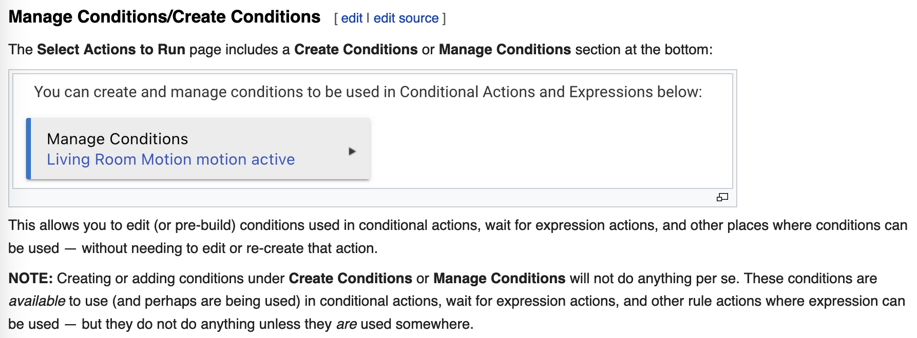

Creating a Condition, by itself, doesn't do anything. You have to use that Condition for it to take effect. It could be used in a Conditional Action (e.g., IF-THEN). Or you could create a Required Expression, and use a similar Condition in it, if you don't want the rule to trigger unless it is within the time window.

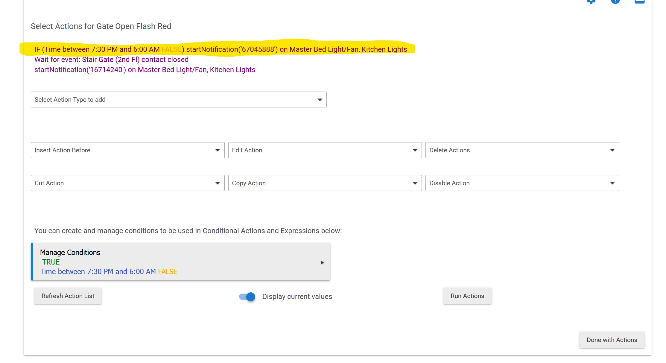

Ah, I think I sorted it out now (will test shortly). Was a bit confused that the place to "create and manage conditions" is within the "Select Actions for..." screen. To me, that implied that the conditions would be respected for that action. I have now created a Conditional Action, using the time condition, and that seems to be what I want:

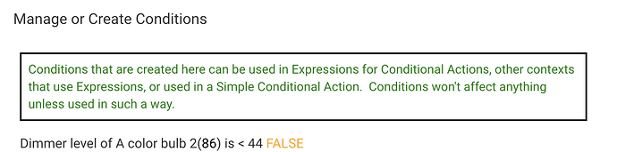

Yeah, people are confused about this from time to time. Will add an explanation on that page.
I think that explanation is clear enough--would have saved me this post :smile:
I'm OK as of now--gate is open and LEDs are not flashing (as expected, because it's still not 7:30pm local time yet. I'll test to confirm the LEDs flash the way I want after 7:30pm
That should work even better than the note I just added to the docs. :smiley:
