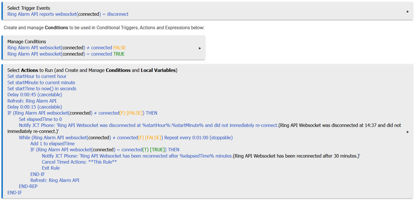

Although I have found that on occasion the websocket does require some manual intervention, particularly when there's been a lapse in my internet connection. I set up a Rule to notify me when it's been disconnected and unable to reconnect on its own.
Yup, same! Good idea about a rule… you could actually have a Rule Machine rule that fixes the issue rather than notify you… :smiley:
Do you always follow the same steps?
It's been a minute since I last had to intervene, but I'm pretty sure I just click the Initialize command in the API device object, which I never figured out a way to incorporate into a Rule. If the power is out for a very long period I might have to reauthenticate in the app.
This Rule has done well enough for me, I get the occasional disconnect notice but most of the time it ends up reconnecting on its own.
Very nice rule! I’ve been lucky on the disconnect front for the most part… but this could be useful!
