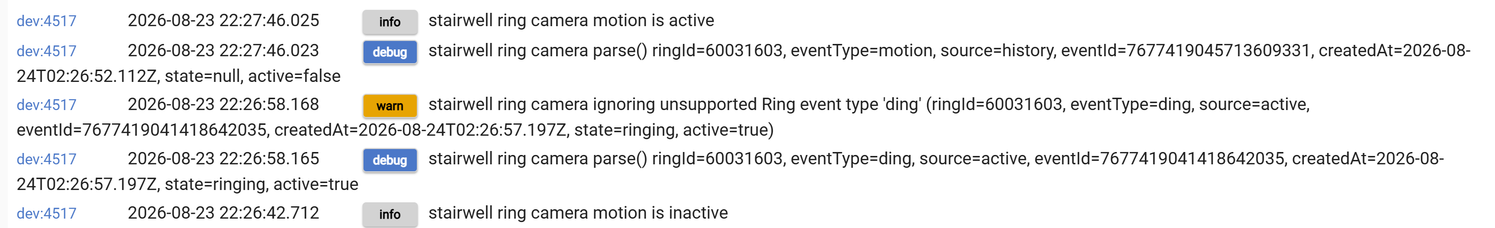

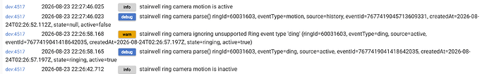

I've been using the motion detection for a couple of Ring cameras. Today I noticed that they don't reflect active motion until about 45 seconds after motion occurs, unless I hit "refresh." I don't recall this being the case previously. I tried logging off and back on to my Ring account in the integration.
Here is a log. The motion occurs around 22:26:58--the debug message at that time says "active=true" (which I assume refers to motion). However, the camera doesn't report that motion is active until 22:27:46.

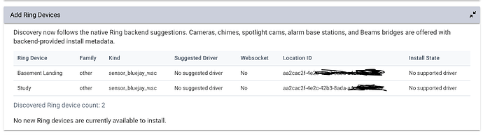

Does this integration work with these smoke detectors? I'm lost in the weeds here. TIA!
I get this when I try to add the smoke detectors.
So my understanding that this is based on a third party device that doesn’t have any information in the reverse engineered api. Since ring has come out with an official API. It's being worked on.
