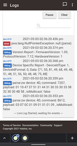

Got 4 of these to replace some aging non-plus motion sensors. All paired fine with my C7, but none of them seem to report motion. I've set the parameters to show led with motion and sensitivity '4'. When pressing the button, the logs show a java error:

Someone said 4 as most responsive somewhere in this forum. However my issue was I got the S2 authentication wrong during pairing. I'm so used to just clicking 'ok' when it asks for the numbers that when I finally got a real s2 device I didn't know what to do.
That was going to be my next question - are you sure the S2 pairing completed successfully? I didn't have a lot of issues pairing mine, but since it is S2, it is worth asking.
Yea.. Ring devices donโ€™t like not having the grants they ask for
