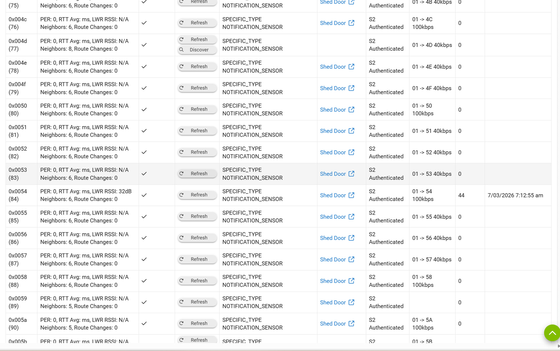

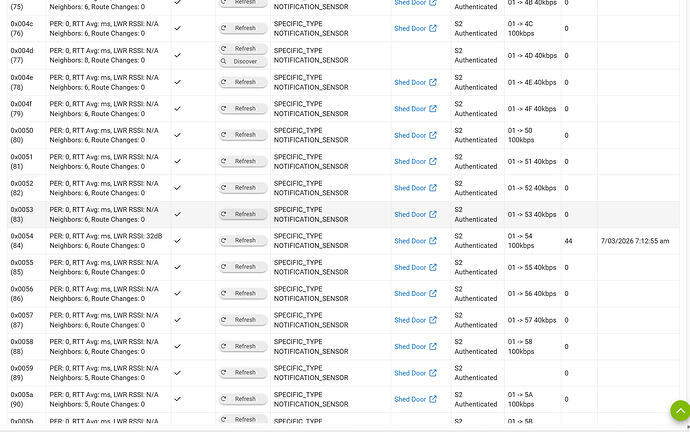

I have a Ring contact sensor that the batteries went dead. I haven’t checked the logs in a while since it is in an outbuilding. Somehow the same device got duplicated around 200 times. Is there an easy way to delete these devices? I put fresh batteries in and it is reporting again.

You have 1 device on that list that is reporting a RSSI value and has a date/time stamp. Leave that one alone. For the others, if you hit refresh, it should time out and give you an option to delete. Hit delete and cross your fingers. This may take several tries (refresh -> delete) and you may need to reboot the hub.
Should the device disappear, rinse and repeat the successful steps and keep an eye on the table in case the entries come back.
If the entries do come back, unless you are doing some weird stuff with zwave pairing, you may want to consider replacing the device.
Not working to try to delete. Just says not responding. Being that it’s the shed, I only have around 12 devices on there. Might be faster to exclude everything and do a reset

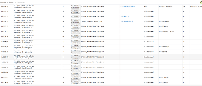

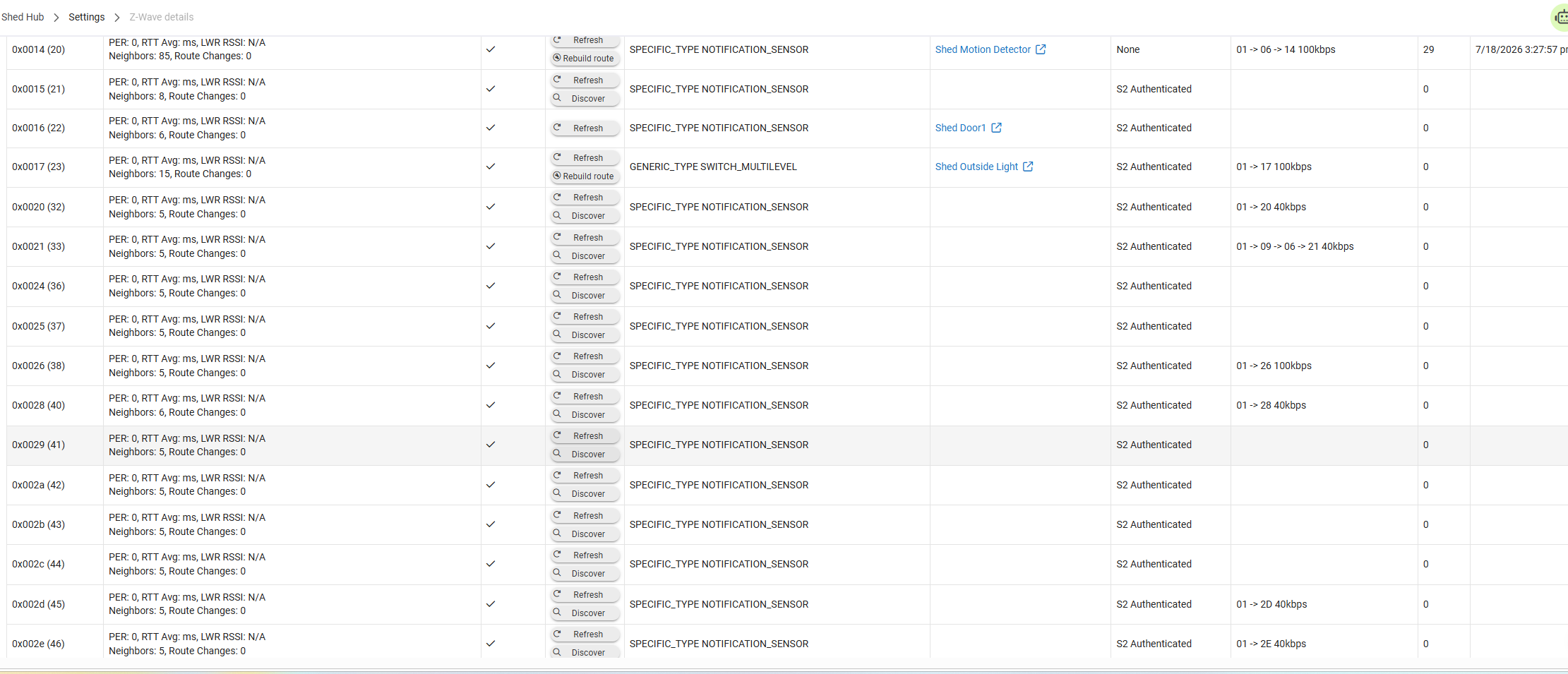

So, I found an old back up on an old computer. I restored it and have my devices all correct again. But when I go to my z wave details page I get around 200 unused nodes. How can I remove them? Forgot to mention that this is a C7
