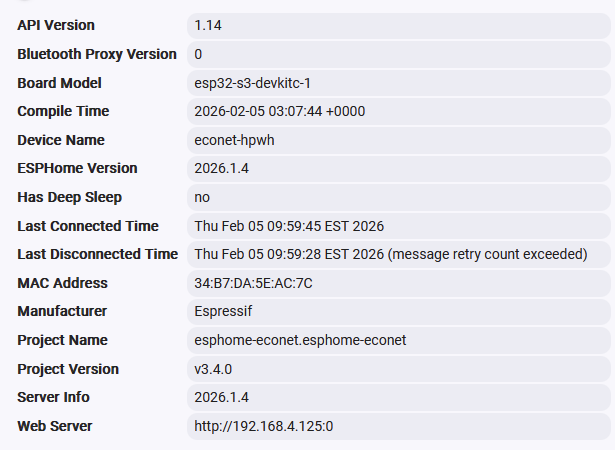

Screen shot of mine.
Can you confirm that you don't have an API key set in the ESPHome config? Go into your HomeAssistant , ESPHome Builder, EDIT on the Rheem ESPHome, Your econet-hpwh.yaml should not have an api: section, it should only look like this:

Bingo that's the problem, thank you!!
I have an api: encryption key block in my espHome device in HA. I was always under the impression this was a requirement to integrate with HA, no?
I assume this is the conflict. HA is using encryption so Hubitat can't connect. Any idea how to remove the api: key from the device on the HA side so I can proceed with this.
Thanks again for the assist!
You literally just remove that block. :slight_smile:

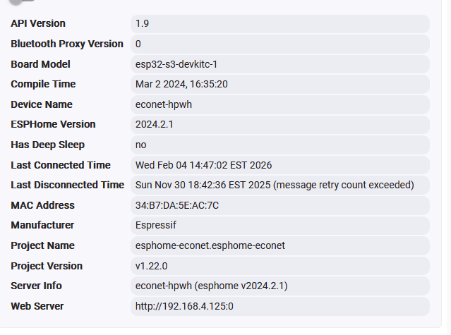

I don't see this on mine, but I am still running OAB firmware:
econet-hpwh (esphome v2024.2.1). I guess I should re-flash my device to get that?
If you have it connected to HomeAssistant, you can upgrade it directly from HA.
..but I don't think that should be necessary to get that parameter, maybe it just hasn't changed? Try clicking the 'Refresh' button on the commands tab in Hubitat, then see if it comes in... It might only come in when it changes.

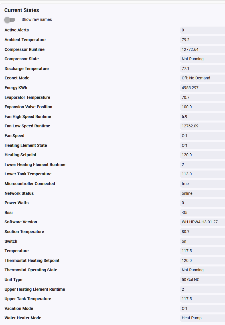

looks like hot water % still not there (this is not critical for me, just musing) but I seemed to have picked up a few more that weren't there before updating the esphome device:
Looks like it might be there in State Variables?

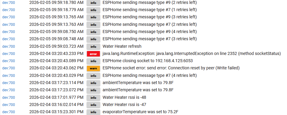

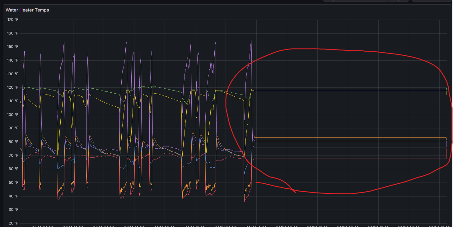

Also...looking at my logs, it appears it stopped communicating again yesterday for a bit until I started flashing it today;

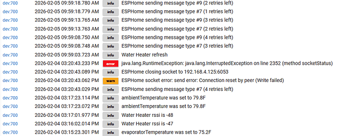

Since I'm piling on (sorry) Also seeing some warnings like this:
ESPHome received unhandled message type 133 with [1:[428570838], 2:[1111784622], 3:[1111723577], 4:[5], 7:[2143289344], 8:[2143289344]]

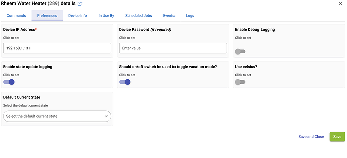

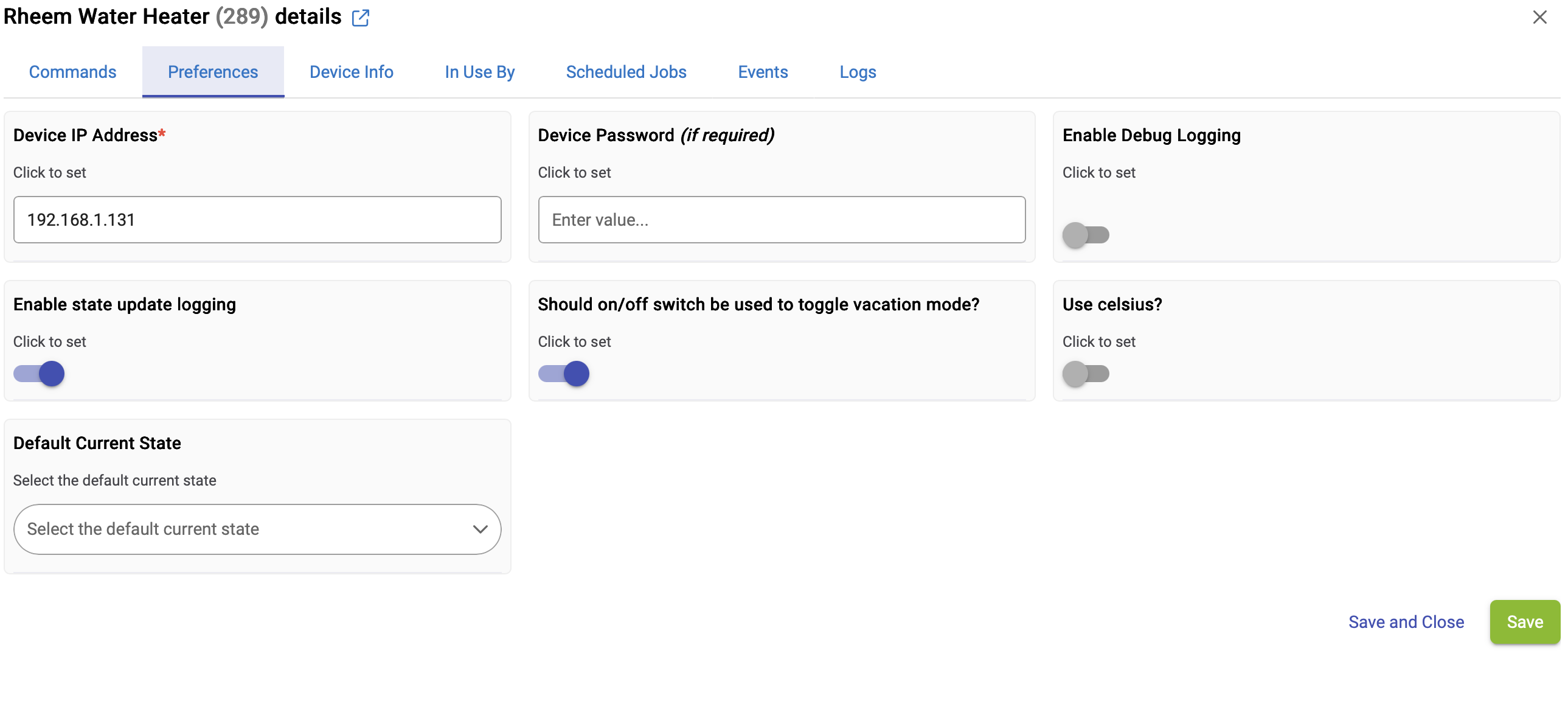

Hm, are you not seeing them as dropdowns on the device page, or in the rule machine?
