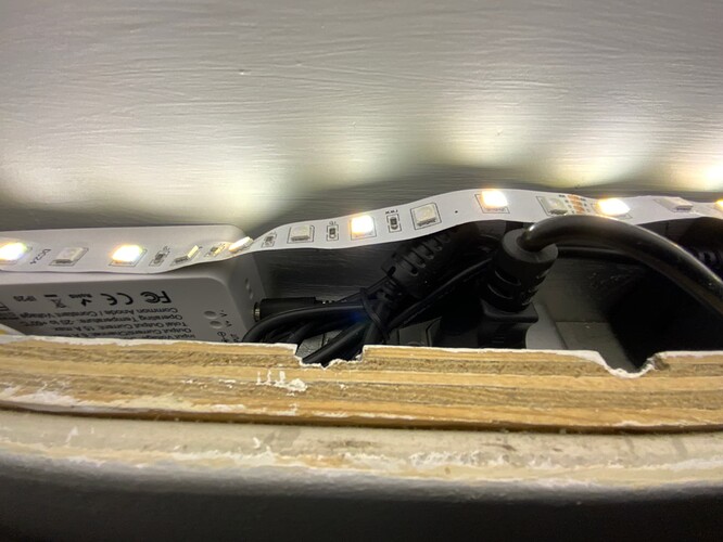

Here’s one - this is Sheetrock on a 2x4 and 2x2 frame:
This is how its powered (This is the top left from the first picture). It is using a Zigbee control via Hue:

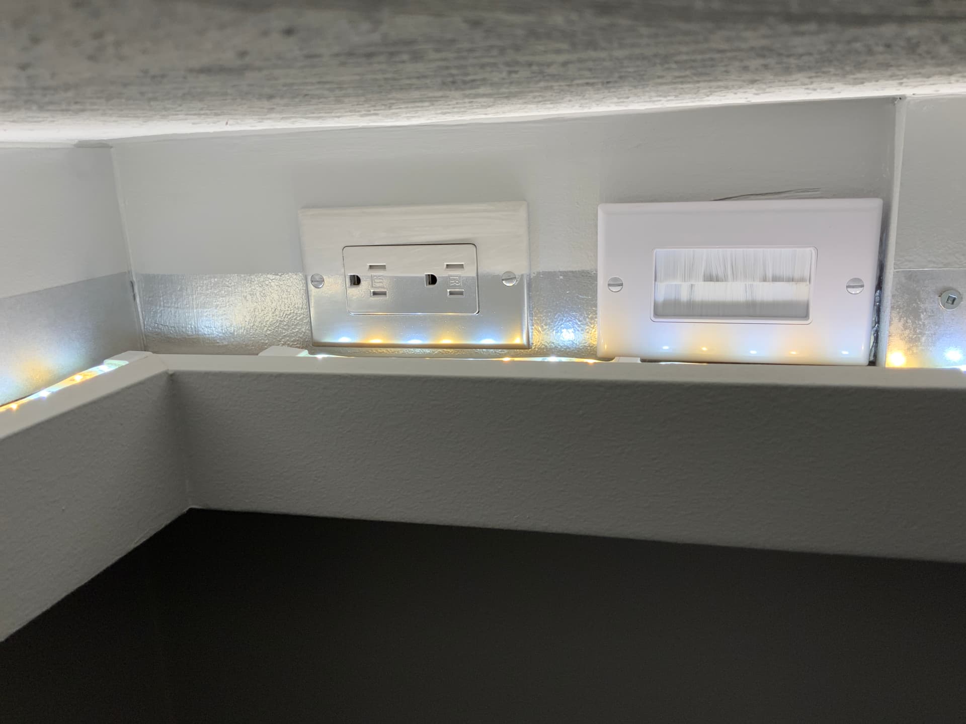

Here’s another one that is built using pressed wood:
It has two power options - Plug or pass-through to a closet:
As you can see, because of the angle, the setup cannot be seen or is barely noticeable from ground level.
For the second setup, I use the Inovelli light strip - works great.
In both setups, I paint the inside with chrome paint to help with the light reflectivity.
