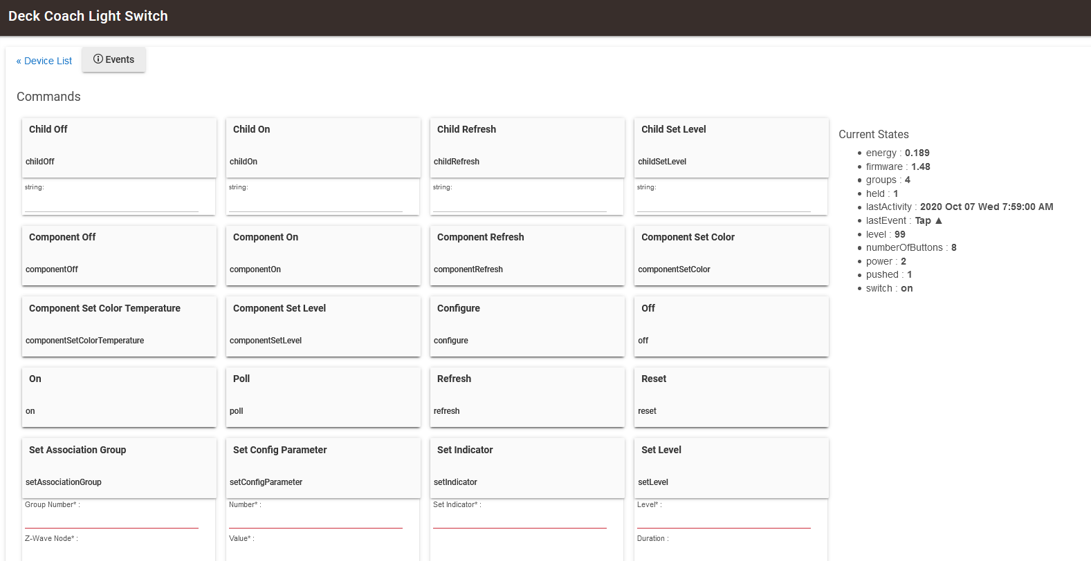

A bit of a weird issue going on. I recently updated the driver for Inovelli LZW31-SN (red series dimmer) with the most current version (10/1/2020) and now some of my RGBW bulbs (phillips hue and inovelli) are coming on with a greenish hue. (all switches running 1.48 firmware) At first I thought it was the inovelli (LZW42 rgbw) bulb so I updated the firmware to 2.30 (fairly lengthy process with the zwave update tool) but then when I turned on another switch with phillips hue bulbs, the same thing happened. I can change the color of the phillips hue bulbs and the inovelli bulb independently but when I hit the button 1 pushed, the lights come on greenish (chartreuse/spring is what is showing in the device setting page). I've tried using the actions of "set dimmer" to 100% and "set color" to soft white (also tried warm white) but I get the same thing. Considering this is happening to two different manufacturer's bulbs and two different protocols (zwave and zigbee) am I correct in assuming that this is a driver issue? It didn't happen prior to updating the driver.
Additional info: when I turn on the bulb using the device driver page the bulb comes on white but when I use the physical switch, it comes on chartreuse/spring. Originally it was chartreuse but now it keeps showing spring as the color,
