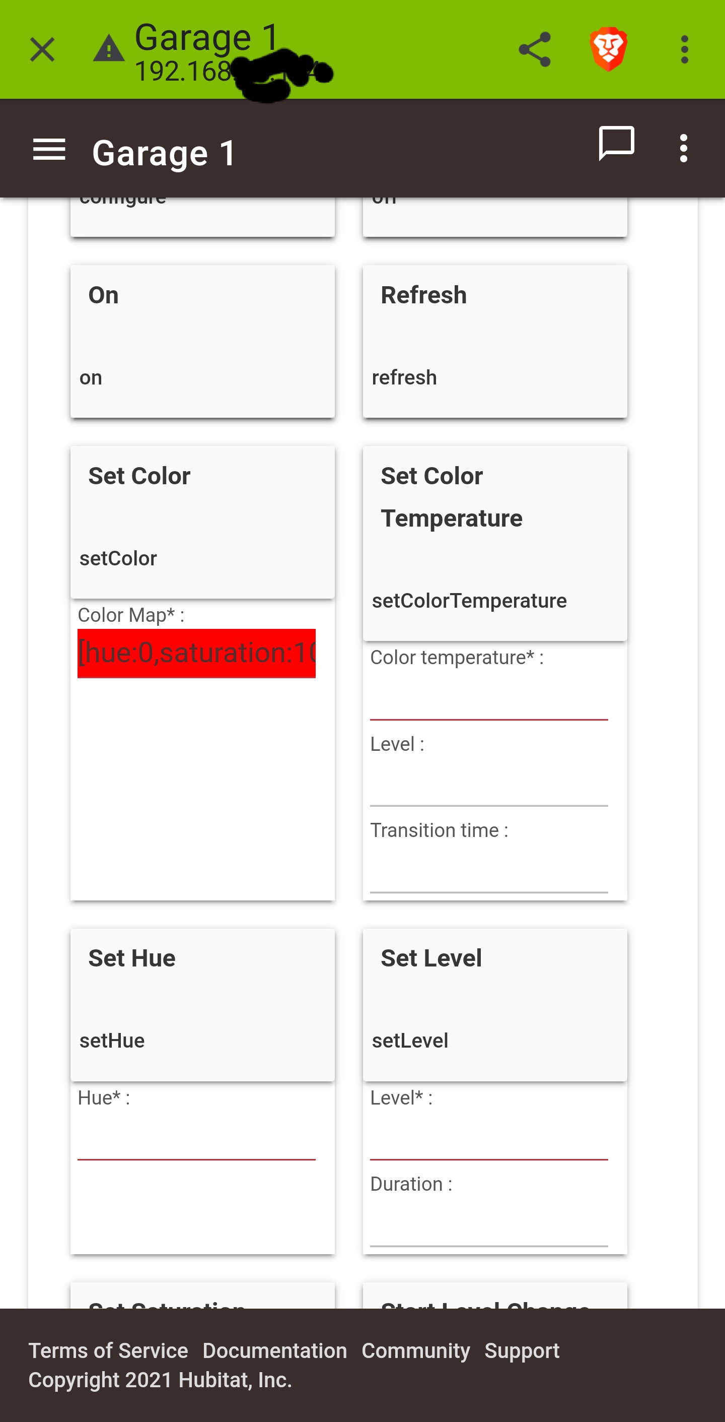

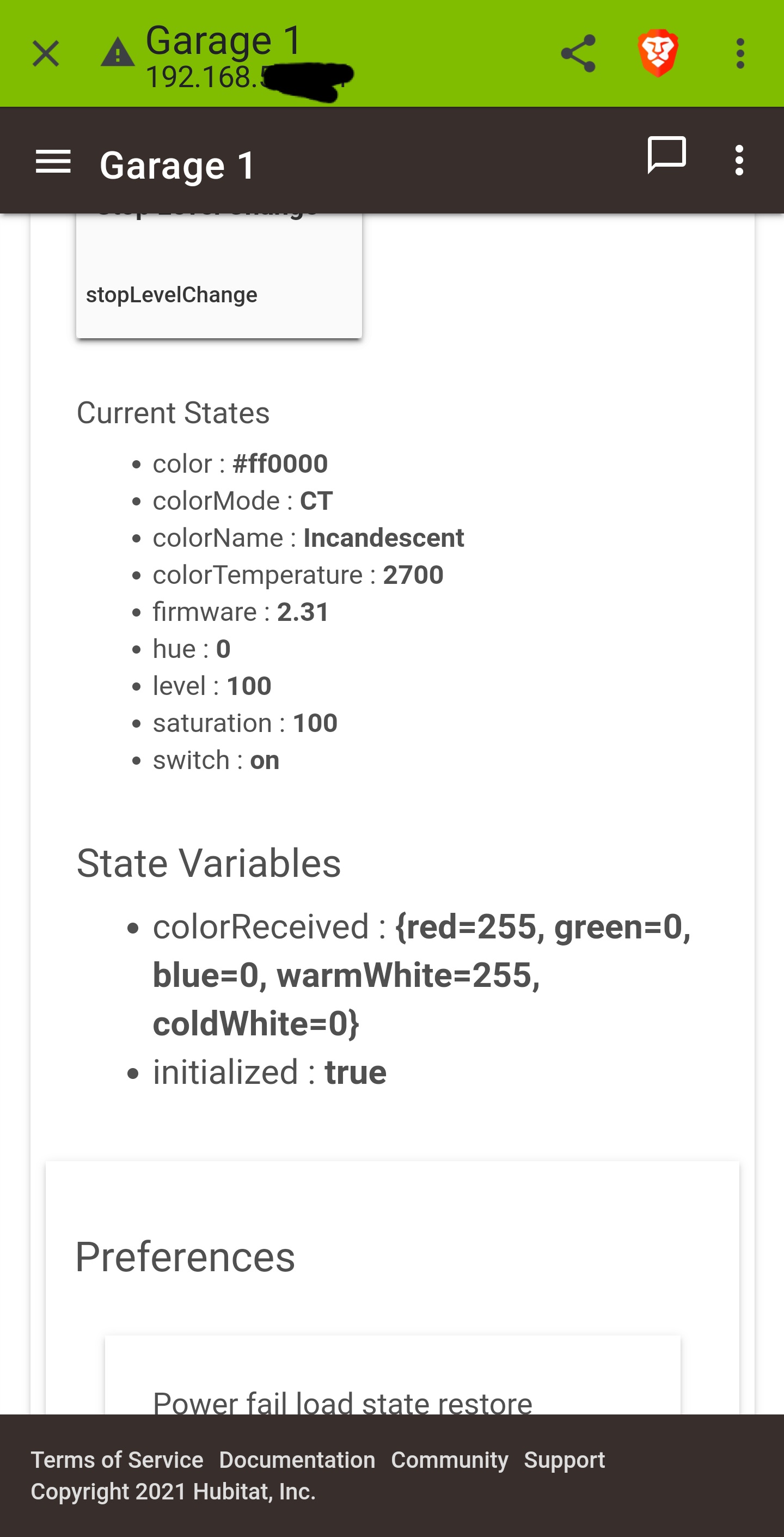

Now it still shows red, even after setting color temperature to 2700, or am.i not fully grasping how these work?
Color and color temperature are tracked differently. The fact that you still see red in that box just means that it was the last color in use (as indicated by hue, saturation, and level attributes, the first two of which are not used for color temperature, which is its own attribute). The bulb may or may not still be that color, depending on whether the bulb is in color or color temperature mode (which a "Set Color Temperature" command should put it in) and whether it's on or off (also not represented with either of these attributes, as that is also tracked separately). If the bulb itself is not actually changing, there is another problem.
