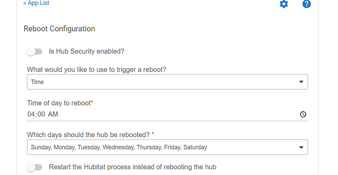

I use this Rebooter App. I actually scheduled it to 4am, so maybe the crash happened before it had a chance to reboot
Looks like you're using the correct option (reboot), so my point is moot.
