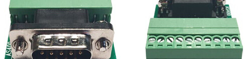

Doing a little searching revealed this
Maybe the terminal block wired to a Zigbee/Z-Wave contact would be all you'd need.
Note pinout of DB9 in document.
But actually, this Relay Mini module has some utility of interest.
Thanks, I found that CyberPower supplies a similar card for their larger UPS systems. But some of their smaller backups have permanent USB and DB9 sockets.
They don’t supply connection information for the DB9, but I guess I could do some testing to see if that wiring is “universal”.
https://www.amazon.com/gp/product/B00429N19W/
Let us know. If getting one of those terminal blocks and wiring in a contact sensor is all that's necessary.... then that's a nice option.

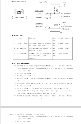

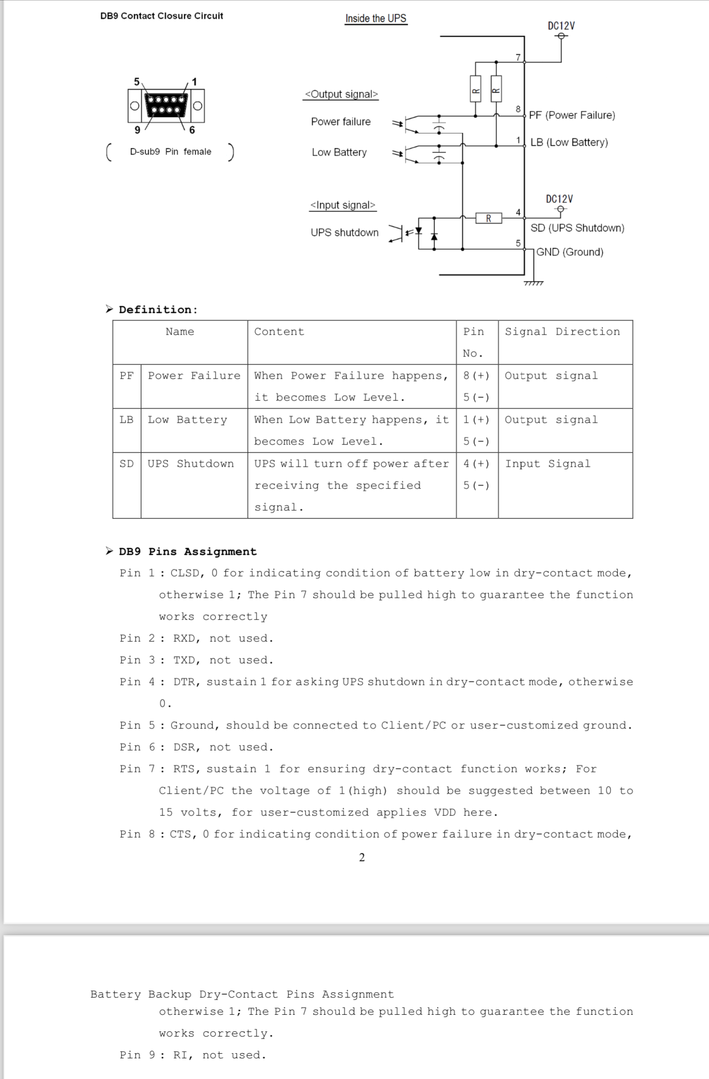

Got this from CyberPower support:
I haven’t tried it yet.
