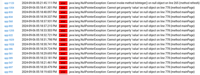

1. Under the "Motion and Mode Lighting Apps", attempting to open 15 of my 17 rules consistently shows the error:
Unexpected Error
An unexpected error has occurred trying to load the app. Check Logs for more information.
Error: Cannot get property 'value' on null object
However, the rules themselves do function correctly.
The logs appear to all reference the same java exception, with various devices:

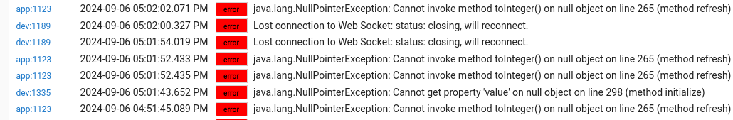

2. I'm also seeing other errors in the logs, which don't seem to be related to opening Motion and Mode Lighting rules:
and

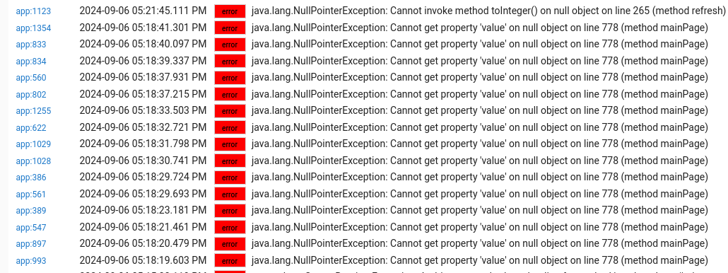

The reset & restore proceeded without any reported errors, but the original issue with Mode & Motion Lighting errors remains -- 15 of 17 rules consistently fail to load, showing Error: Cannot get property 'value' on null object and logging the message:
java.lang.NullPointerException: Cannot get property 'value' on null object on line 778 (method mainPage).

java.lang.NullPointerException: Cannot invoke method toInteger() on null object on line 265 (method refresh)
dev:11892024-09-10 03:04:00.234 PMerrorLost connection to Web Socket: status: closing, will reconnect.
dev:13422024-09-10 03:00:00.105 PMerrorgroovy.lang.GroovyRuntimeException: Ambiguous method overloading for method java.lang.Long#minus.
Cannot resolve which method to invoke for [null] due to overlapping prototypes between:
[class java.lang.Character]
[class java.lang.Number] on line 396 (method healthCheck)

Actually, importing the rules from Motion & Mode Lighting into Rooms Lights was successful for 16 of the 17 rules -- even though 14 of those generated a java.lang.NullPointerException error.
Within Motion & Mode Lighting, 15 rules could not be opened -- attempting to do so produced a java.lang.NullPointerException error, even though the rules continued to run correctly.
