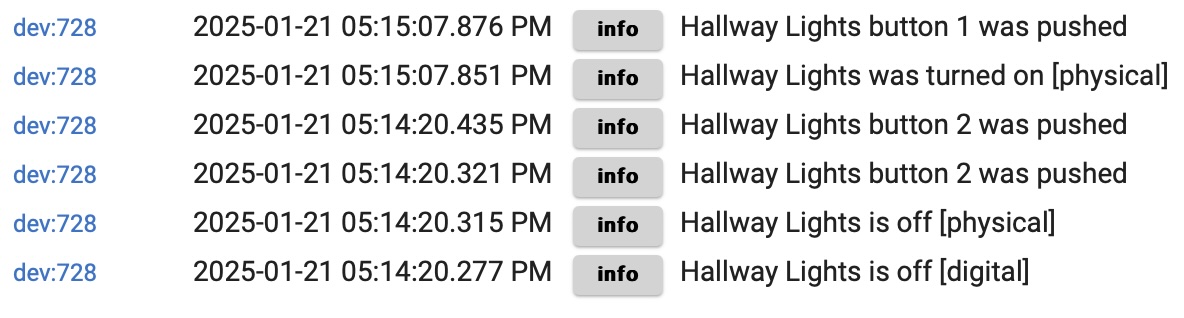

I did more experimentation today. The Z-wave radio seems to be receiving but not transmitting. For example, once connected to the Hubitat via my browser, I select a specific light switch for viewing. When I click either the "on" or "off" button in the browser, a "Command Submitted" message appears but nothing happens at the switch. Also, nothing appears in the log. However, if I physically press the light switch on/off, a message appears in the log.
I noticed one other thing, if I unplug the Hubitat for 30 seconds and plug it back in, I can control the light switch via the browser for a very short time - about a minute. After about a minute the Hubitat can no longer turn the light switch on or off. I attached a screenshot of the log for the light switch. Note that I plugged in the Hubitat at about 5:14 PM.

Here is the log:

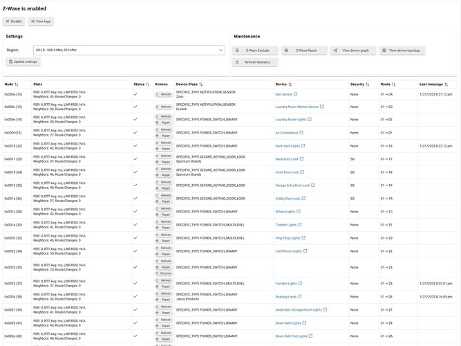

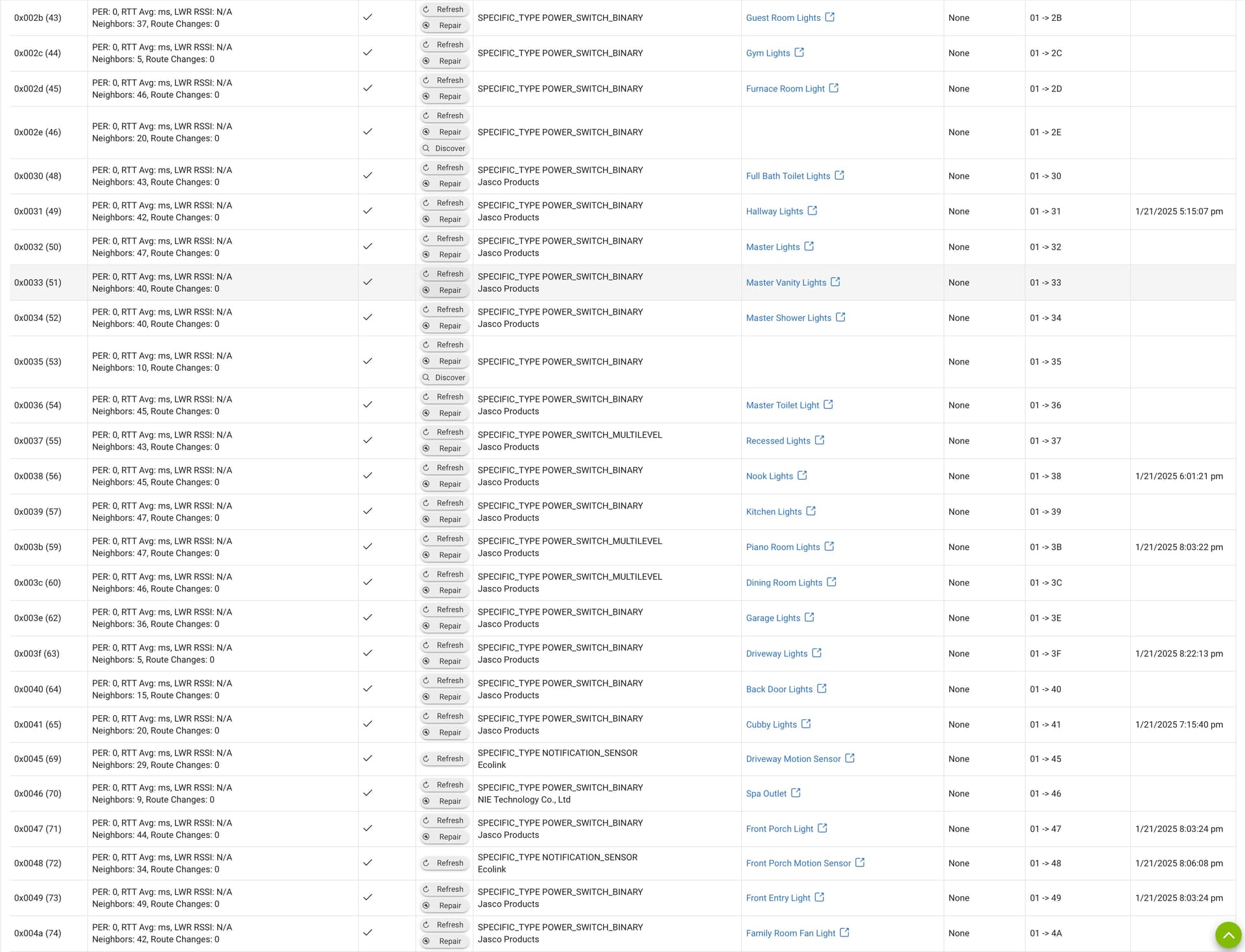

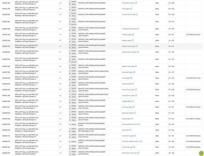

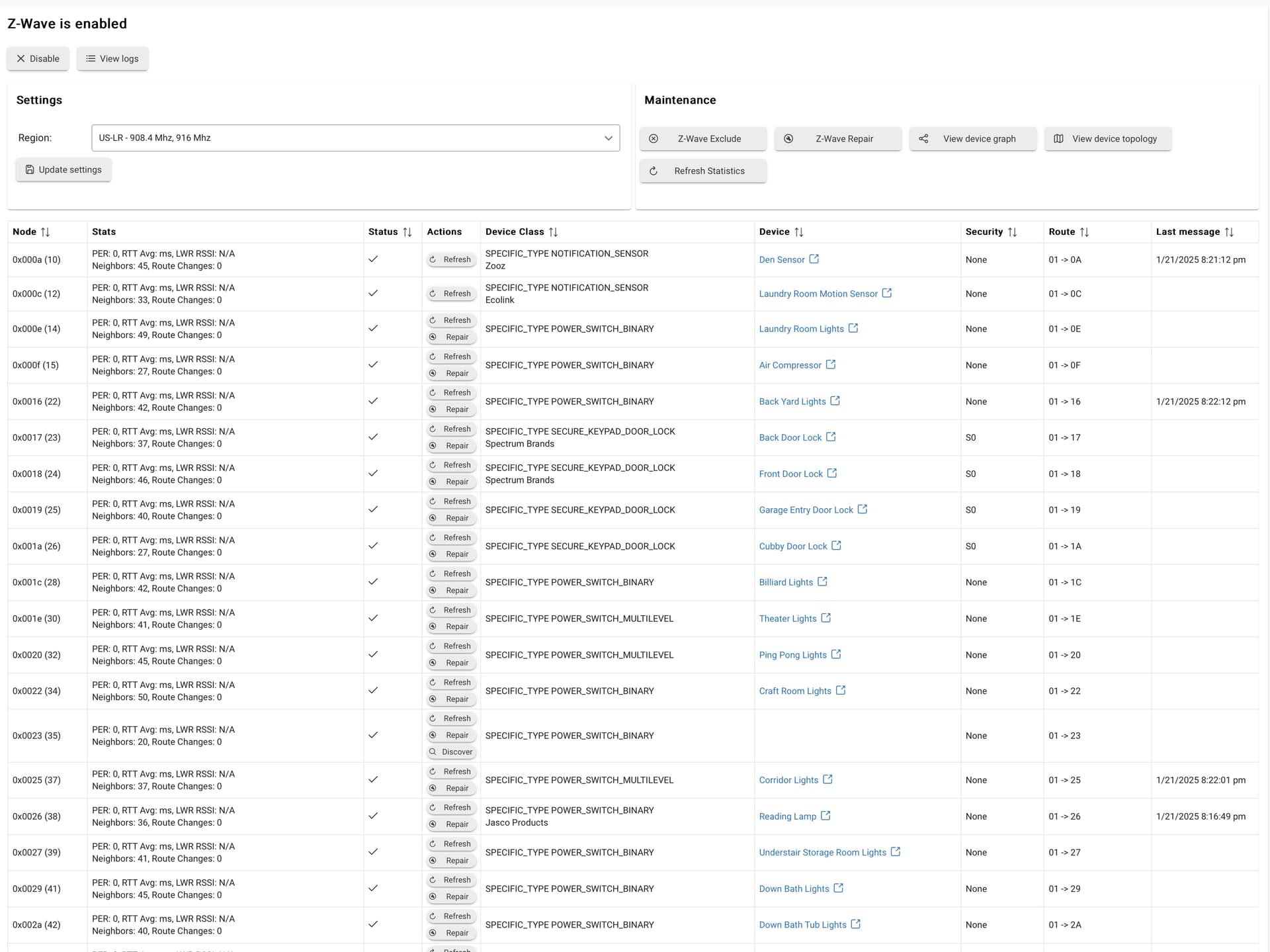

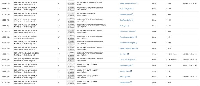

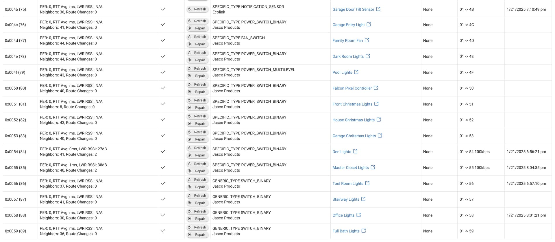

I looked at the relevant part of the link that you sent. I have about 90 devices in my system. Here are some of the stats:
  1. PER: 0 for all devices.
  2. RTT Avg: ms (there is no value here for all devices).
  3. LWR RSSI: N/A for all but 2 nodes. 27 and 38 db for the nodes that are not N/A.
  4. Neighbors: Typically 30-45 with a few nodes in the 5-15 range.
Here are 3 screenshots of the details page:
You have a few ghost nodes that need to be removed. Also, how long had the hub been running at the time of this screenshot?
Hub has been up for about 4 hours (I power-cycled it when I changed to a new power supply as somebody mentioned). I think I count 3 ghost nodes if I am looking at this correctly.
