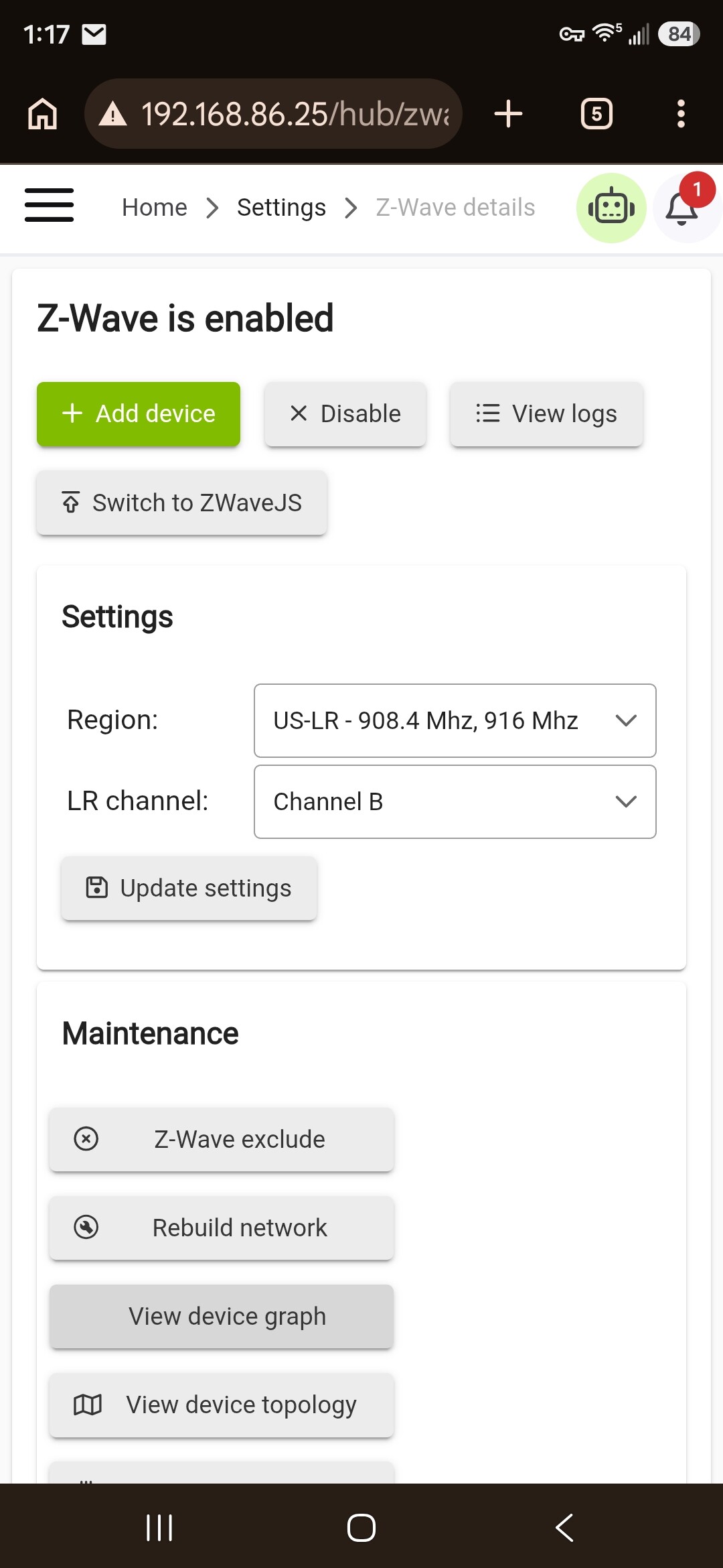

Is your hub using ZWJS or Legacy (Zipgateway)? The one I have seems to work ok.
I assume im running legacy since I see a button on the Zwave details page that's called "Switch to ZwaveJS". I was running a C7 hub but upgraded it to a C8 Pro several months ago.

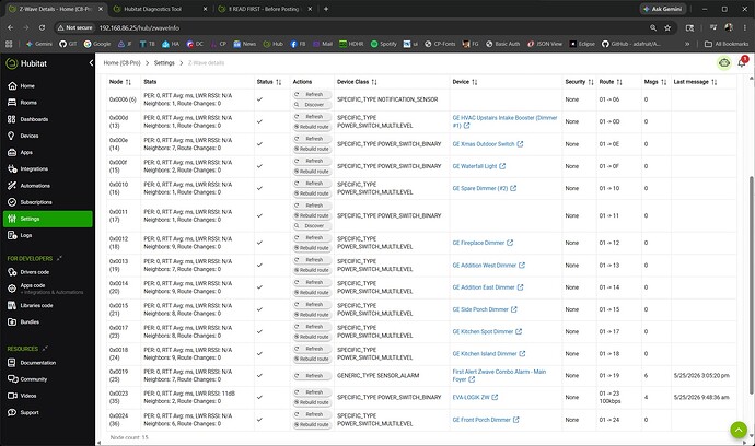

I have a EVA LOGIK ZW97 and it's working flawlessly. Would you post your z-wave details page in its entirety?
You only have 4 devices?
I have 15 Zwave devices. I have over 200 other device types
You have at least 2 ghosts (6 and 17) , you probably have more. Get rid of them and likely everything will run fine.
I see 2 node 0x6 and 0x11
Yup - same two that Rick noted. "Discover" button on those is a clear giveaway that things are not right.
