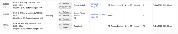

I don't think I've got any ghost nodes. I'll follow up with some screenshots of my "Z-Wave Details" page.

In the first post you seem to have done everything I would suggest as I had many problems joining these locks in the early days.
I do see you have many ghosts in your ZW mesh.
Anything without route, blank info, or Pending needs to be addressed first.
You may have to repair or remove try to add those back.
Those are... not ghosts? Well, maybe they are -- not sure how you define that. I can't communicate with them because I had to move my hub into the garage near my lock. So they are only temporarily unreachable. There are also a few battery powered devices that don't respond to pings, but the devices work otherwise (when my hub is in its normal location).

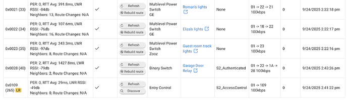

Here's my Z-Wave Details now:

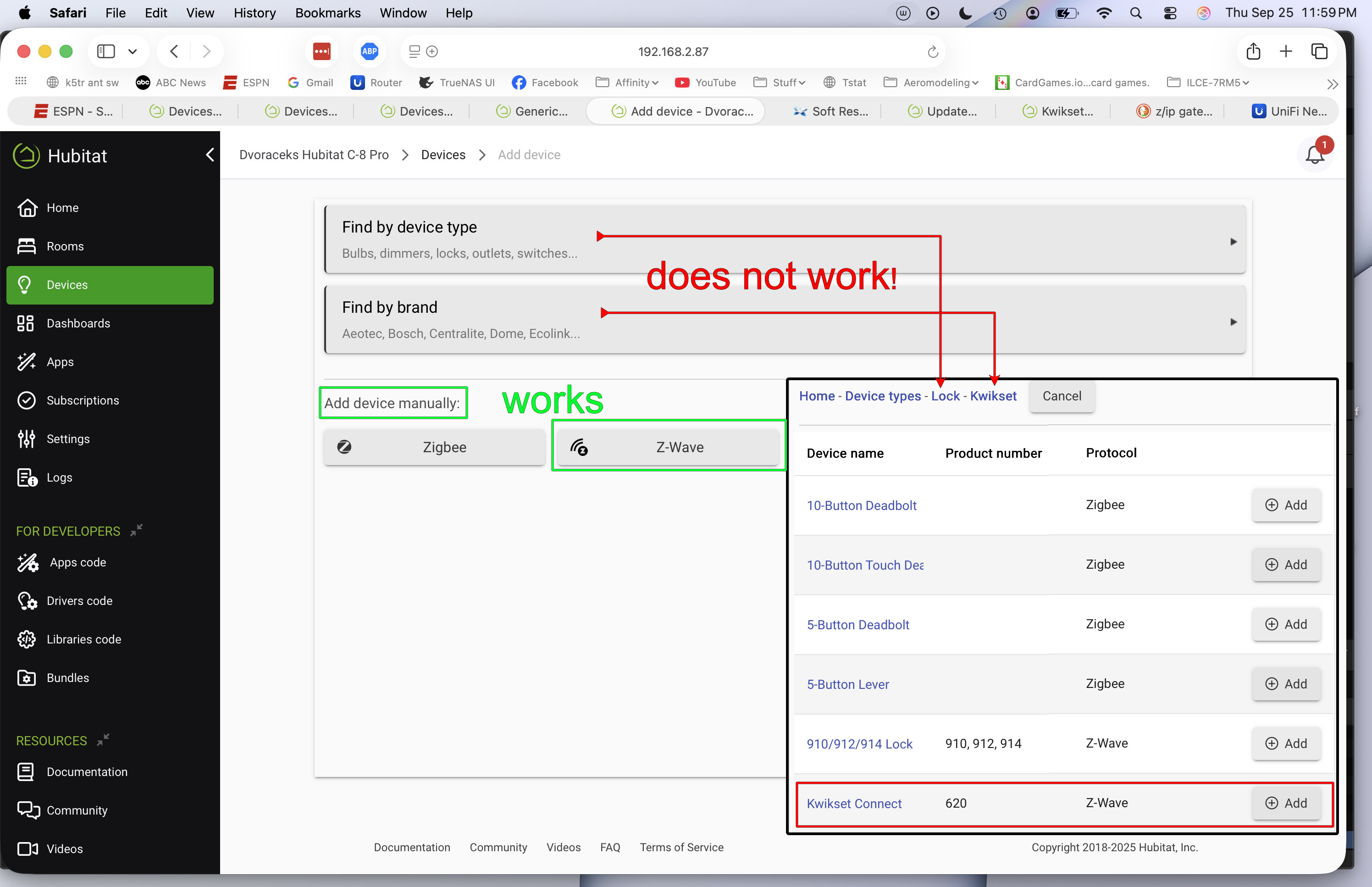

This may not help, but I just replaced a Kwikset 620 that was failing, and I had a lot of trouble getting the new 620 to pair. I could not get it to pair with SmartStart and I could not get it to pair using the Device>Add webpage when I specified I was adding a Lock>Kwikset>620. However, to my utter relief and amazement, it paired when I didn't filter for a that specific device. I note it and my other two 620's are paired as "generic locks". I don't know if this is related to the discussion but I thought I would mention it.
@aaiyar Thanks, it was reports like yours that convinced me to go with the Kwikset 620 in the first place!
@john.ke5c I've been kind of wondering if the process of choosing the device type, brand and model of lock does anything at all, since this lock just uses the Generic Z-Wave Lock driver. I've definitely tried it both ways, but most recently I've been clicking through and selecting the device type, brand and model each time. If I make any more attempts I'll just skip this!
After I posted, I found my original notes from March 28 (link below). At that time I was able to pair using Lock>kwikset 620 but I sure could not yesterday. Something has changed either with Hubitat or Kwikset software/firmware. I suspect Hubitat since the Kwikset is probably close to locked in stone. I agree, odd that you can select the lock but it just uses generic lock profile. March post
Good luck! -john
It does not. Choosing a specific device in the list just gives you the instructions how to to perform the pairing.
Many of us old timers just skip right to the Z-wave or Zigbee button instead of using the prompts, that is all we used to have before UI improvements.
The only thing I could see how it could make a difference is if a device has both a Zigbee and a Z-wave version, and you somehow chose the wrong version and didn't notice that the buttons you press for pairing had the wrong protocol listed.
