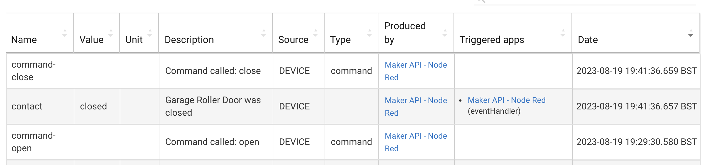

So this time (for the first time) when I check the events, 'Produced By' shows 'maker api - node red' as the source of the open command as well as the close:

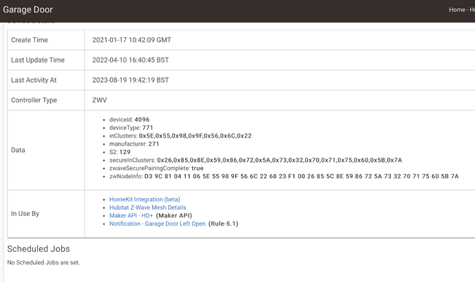

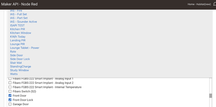

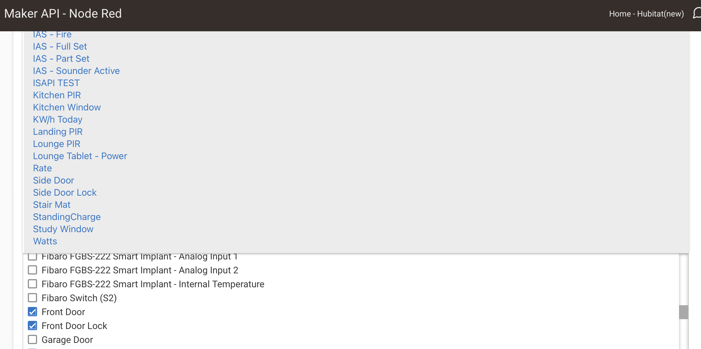

1 - 'maker api - node red' should not be able to open the garage door as I've explicitly not allowed it - the device is and always has been unchecked for that instance:

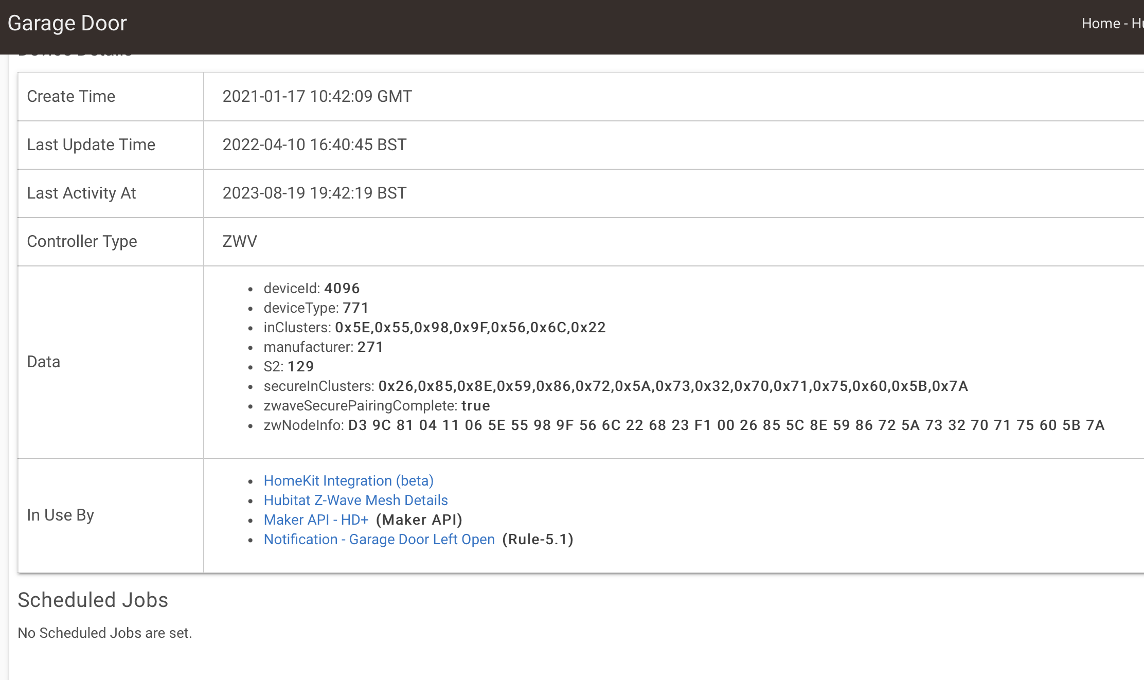

That instance of maker api is not shown in the 'in use by' section of the device either:
2 - I closed the door myself using a dashboard, which uses a completely separate instance of maker api named - 'maker api - HD+'

It is.not.called garage door your rule says garage roller door. Is that a different device?
Did you ever have Garage Door enabled in Node Red?
Show the App Status page Settings for the instance of Maker API - Node Red.
But the device events show that coming from Maker API - Node Red, and the following close command also coming from Maker API - Node Red.
Apologies for the delayed response - I'm in the UK
Aww bollocks....Garage Roller Door is a different device (a virtual contact connected to my alarm system using mqtt). I've grabbed the events from the wrong device - the contact that is on the door that opened. I'm feeling a little stupid now
As above - my bad for grabbing the events from the wrong device. Apologies

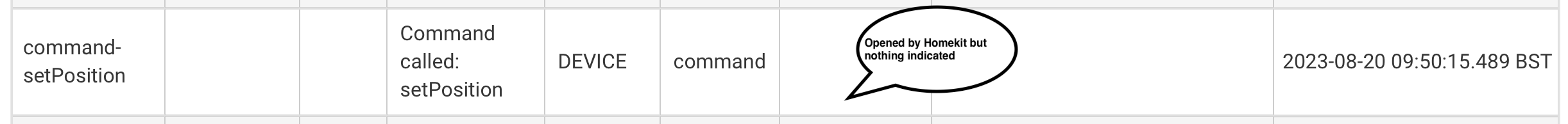

It's still unknown however what caused the door to open on its own. There are no rules that can open the door and I've gone as far as adding a relay to my alarm system that breaks the power to the line open connection when the system is set. I'm back to blaming the Homekit Beta. It's feasible that a HomePod heard something from the TV that sounded like 'Hey Siri, open the Garage Door' The correct events are shown below:
The 'produced by' is empty so I don't whether it was Homekit or not. I'm sure that 'produced by' never identifies the Homekit Beta when it is the trigger. That stops me identifying the cause.
The only other thing I've not checked, is what is logged when I open the door using the switch which is connected to the 'Garage Door' module (Fibaro Roller Shutter 3). If operating that switch populates the events table with an identical entry to above, it's possible that the switch itself could be at fault.
I'll do an open and close from Homekit, followed by an open and close from the switch to see how they're logged and report back.
Opening the door using Homekit, the event is shown below - unidentified:
Opening the door using the switch connected to the module, it just reports power, position and status without "command called: setPosition"
That proves it wasn't the switch and with no rules set up that can open the door (Maker API - HD+ can open it but 'produced by' always identifies that when used):
It can only be Homekit that opened the door even if there's nothing indicated. Hubitat doesn't show it in 'produced by' and unlike Amazons Alexa, Apple don't provide a means to check history. Diagnosis by crystal ball perhaps...

@bravenel - the command shown that corresponds to it being opened is shown at the bottom of this image (command-setPosition 19:29:20:166 :

With no "Produced By" entry, and the source being DEVICE, I'd take that at face value. If it were an app, it would show the app in Produced By. This is exactly how my Z-Wave relay looked when my garage door opened -- a command with no obvious cause. Disconcerting.

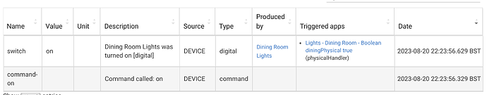

@Bravenel That's one point that I'm making. See below that I posted earlier today. This is the result of opening the door with Homekit. Homekit does not populate the 'produced by' column. It should but it doesn't...
That's the case for all devices - Homekit is not identified when used. I just turned on the Dining Room light with Homekit - here is the event - no reference to the Homekit app:
I've posted regarding this a few times

Do any of the actions taken in Apple Home (other than by the Garage Door) have the app in the "Produced by"? I use MakerAPI/Homebridge and it always shows the name of the MakerAPI instance that is connected to Homebridge.
No. As mentioned I've commented on this a few times and tagged Victor but didn't get a response. Anything using maker API (inc Homebridge when I was using it) populates the "produced by" column. Any device, when turned on/off by Homekit beta leaves it empty.
In this scenario it would only prove that Homekit opened the door but not why. Only Apple have access to the Homekit history. "Produced by" should list Homekit beta though when it's the source, but it doesn't
HomeKit integration does not currently populate the Produced By field. We will address that... So it is one possibility that someone used HomeKit to open the door.
