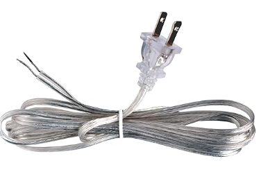

Just get something like this and a pair of connectors, either wirenut or Wago and plug it in.

For many In-Wall devices, there are screw terminals and the bare wires work well. For those devices with their own wires attached, the wirenuts or Wago make for easy connecting. Then when I'm done, the wirenut/wago goes onto each wire and I throw it into my tool box for next time.

I have tuned my process over the years to make adding a new device as painless as I know how. When I get a new device, I add it to one of my development hubs, test it and then remove it from the hub. That wire makes the process of verifying a new device simpler. I don't have to mount it in-wall, I have it near to hand in order to do the include 'dance' and to verify it works once added.
If you feel the edge of the wire, one side has a ridge... that's neutral and should be wired to White on the device. It's a temporary solution and should never be used for anything but a couple minutes worth of verification.
That looks exactly like what I was half thinking about, I just wasn't sure how safe it would be. Actually I was thinking about cutting the end off an extension cord. But this gives me a clearer idea what to do!
