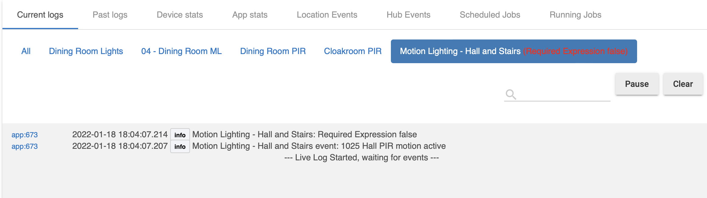

That's not the case for me - the rule is not running and if I go into the logs it shows that it is not running because the required expression is false (even though it is true and being evaluated as true). Log shown below - I've purposely left it faulty for now:

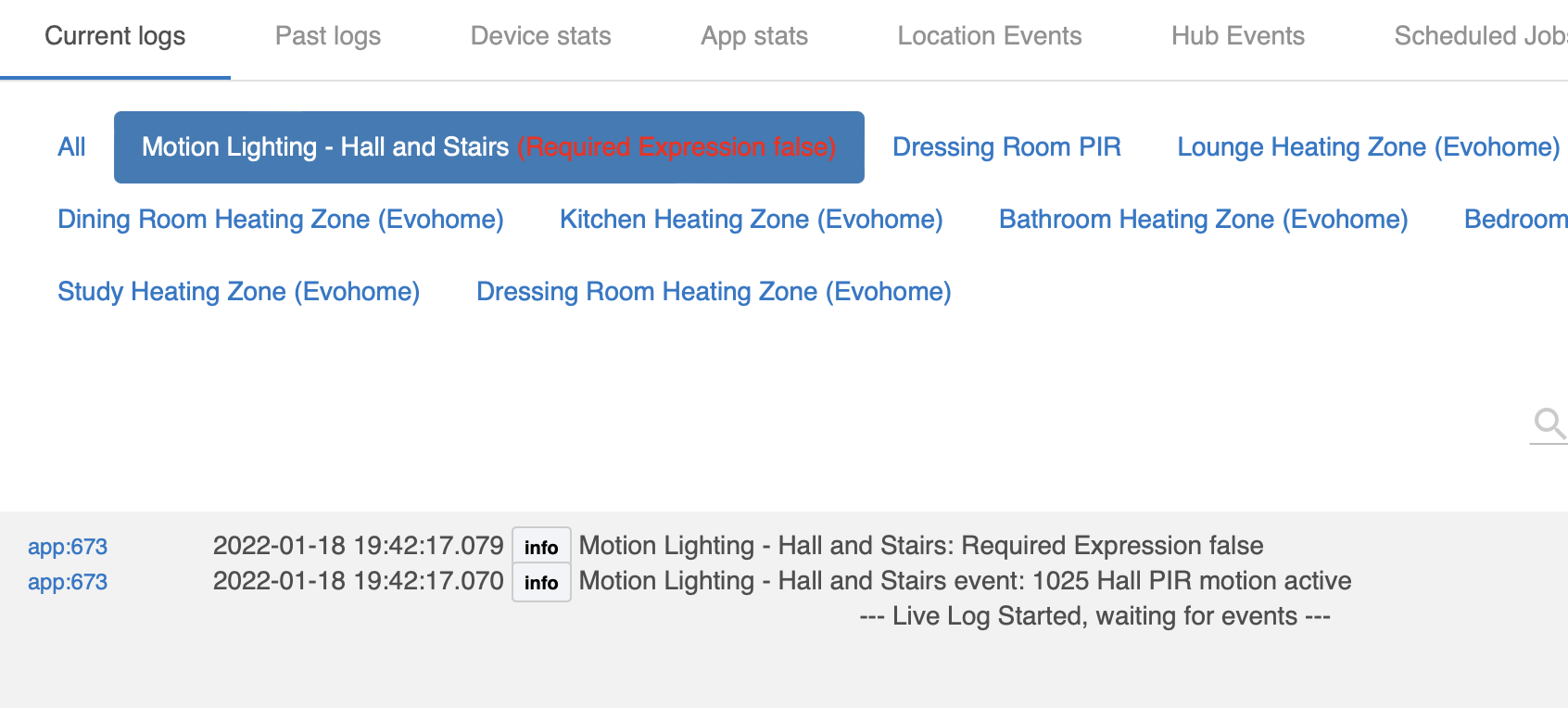

This is the Hall and Stairs now. It's not working as although the conditions for the required expression are true and are evaluated as true, the heading at the top shows false. The log confirms the reason for it not working as required expression false:

On Jan 15th after sunset one of the two (landing and stairs) failed to work, while the other (hall and stairs) was working normally. In both of the rules, the required expression (sunset -15 to sunset +15) was showing True, yet the rule that wasn't working had the "Required Expression False" message at the top and on checking the logs I found that "Required Expression False" was the reason for it not working.
Today after sunset the rule (hall and stairs) failed to work, while the other (landing and stairs) works normally. Again in both of the rules, the same required expression is showing True, but this time the Hall and Stairs rule has the incorrect "Required Expression False" at the top and again it is detailed in the logs as the reason for the rule not running.
