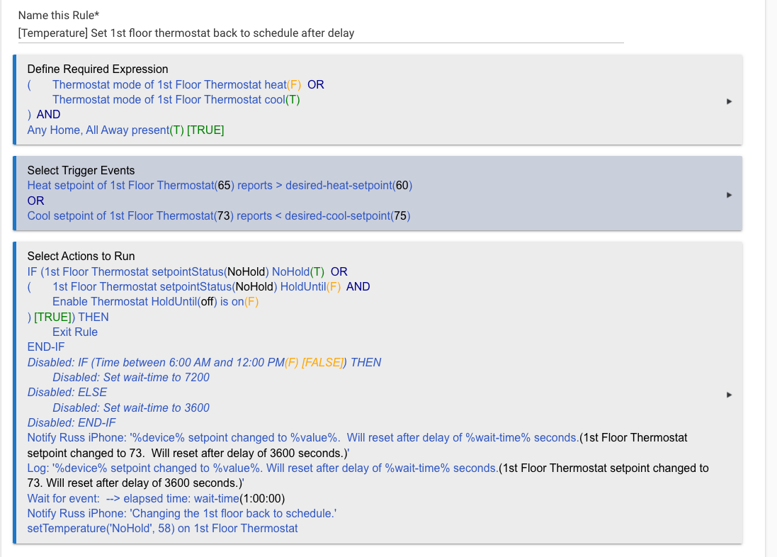

I have two rules that have very similar required expressions:

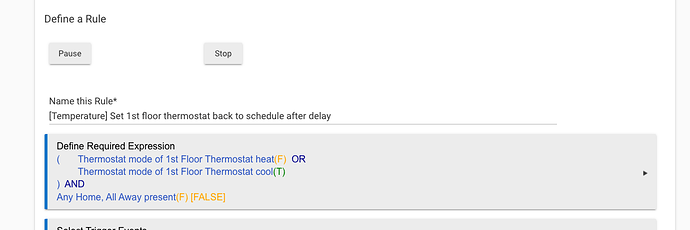

The desired intent is to never run this rule unless someone is actually home. As seen in this screenshot, I'd expect this to not run since the expression evaluated to false.

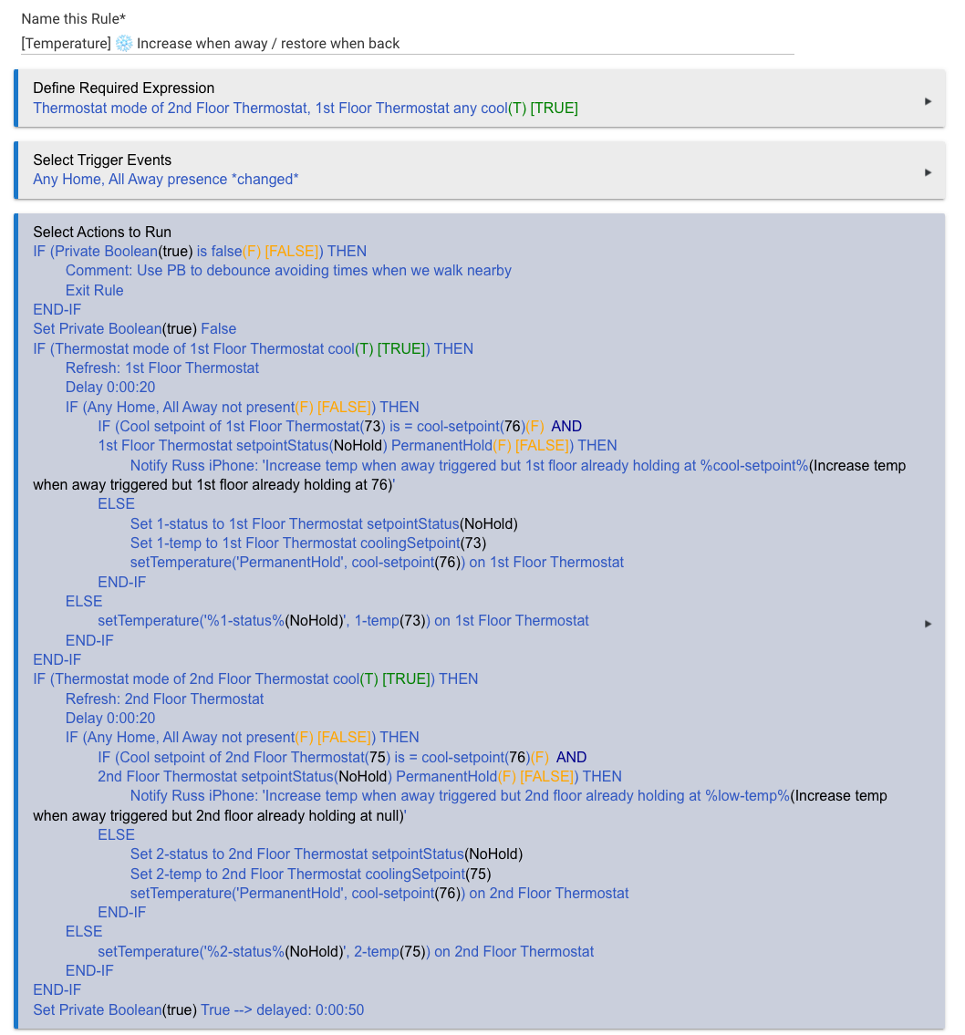

However, I have another rule that changes the thermostat settings when we leave and in doing so, is triggering this rule which is unexpected since the away rule can only ever trigger if the presence changes. In the log shown below, app 936 is the rule that changes the setpoints when we leave and it is triggered because "Any Home, All Away" was not present (shown in log). After it changes the thermostat (at 2022-07-10 01:21:30.165 pm), we see app 934 get run even though, as shown in the screenshot above, the required expression is false at that time.

Full rules in case that's helpful:
  1. app 936
  2. app 934

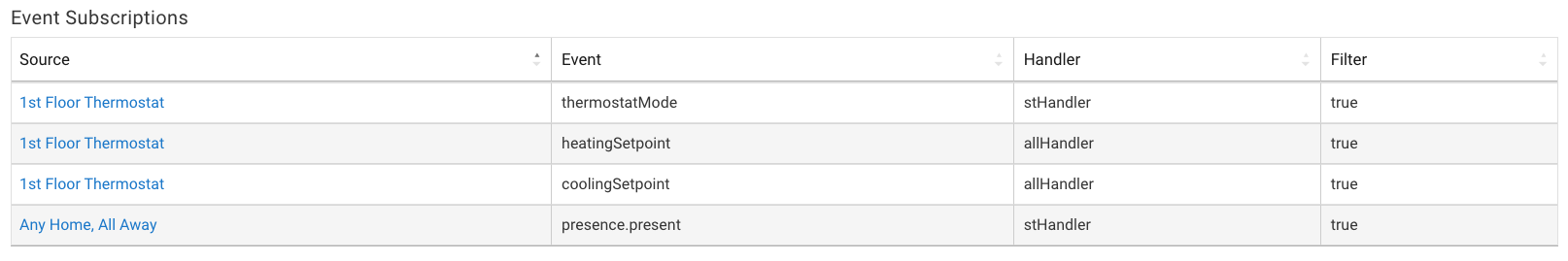

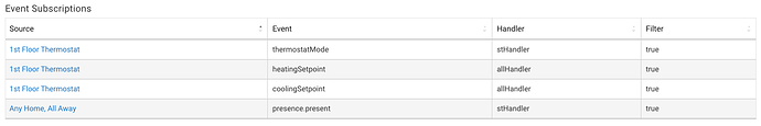

Sure, here are event subscriptions for app 934
The problem is presence.present
That causes it not to see the departure event to flip the Required Expression. As in interim work-around, you could use another rule that sets a variable based on presence changes, and use the variable in the Required Expression.
