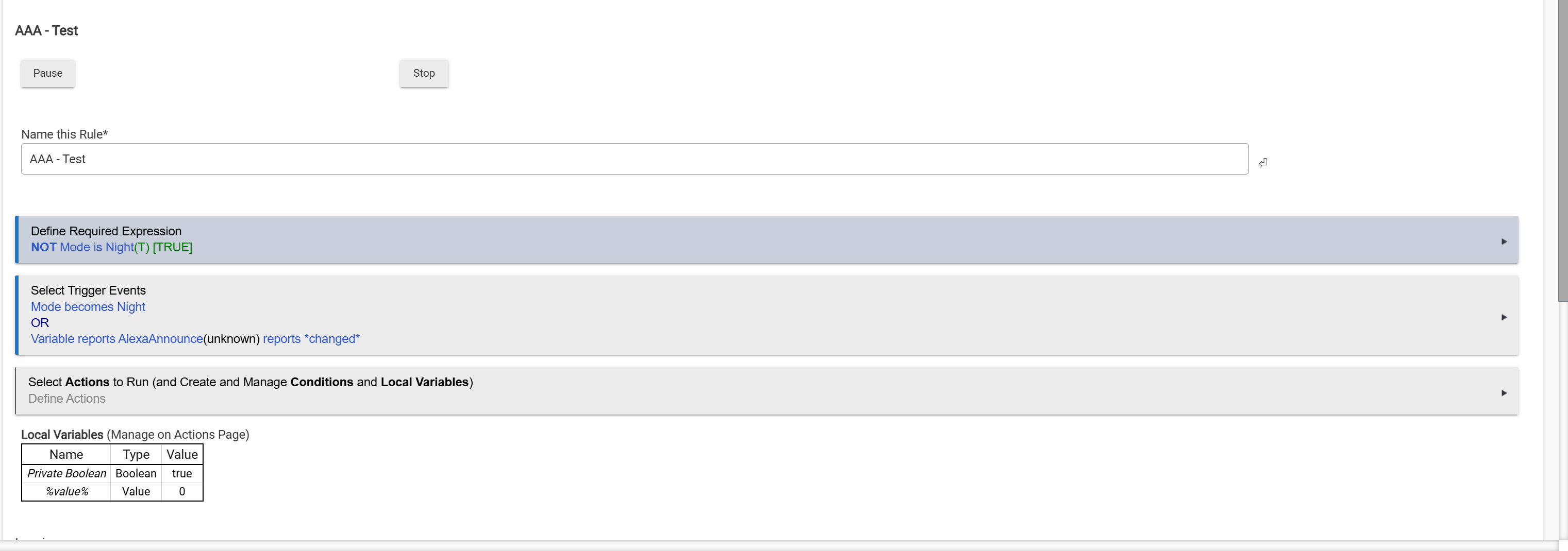

Is the screenshot below what you describe? So it should trigger only when Mode is not Night, DeckNite in your case. I seem to remember it being said it's not good practice to use the same device to trigger and be part of the required expression? Not sure about that but I usually try to avoid it.
I'm sorry, I tried to be concise and clear but obviously I failed. Your screen shot is correct except for one crucial detail. The trigger for Mode becomes Night was DISABLED. I expected a disabled trigger to be the same as deleting it (and it usually is). But in this case, it triggered anyway.
You are right that mixing RE and triggers on the same device can have somewhat unexpected behavior (basically, the state of the RE is evaluated BEFORE the change that the event is causing - this is why Mode becomes deckNite triggers despite the RE of NOT Mode Decknite). But all of that is by design, predictable and understood. It is simply the fact that a disabled trigger triggered that seems like a bug to me. If I delete that trigger instead of disabling it, everything works as expected.
