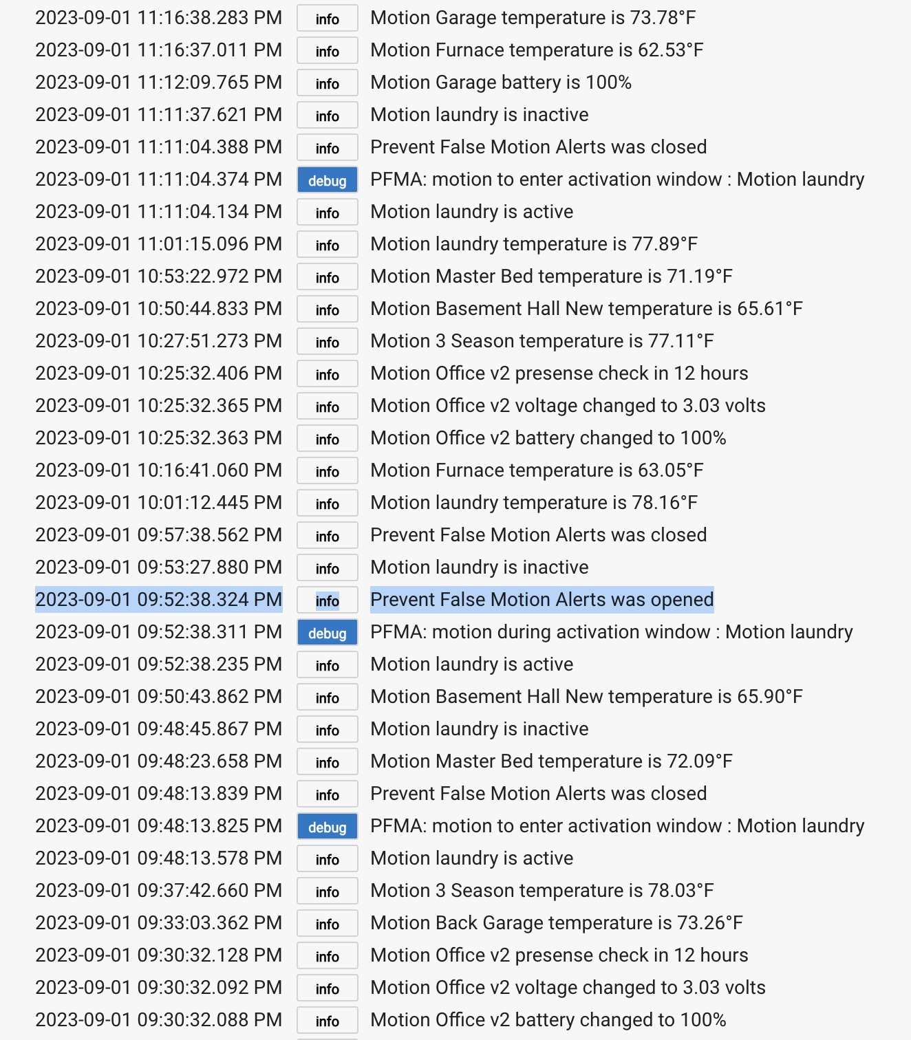

Just tested this for the first time from being away for 2 days and it worked as expected. I can see the laundry room sensor triggered 7 times (one of those times there were two close enough to reach the second stage of this app) during this period, sometimes at night. Unless that was a headlight ambient light trigger this sensor seems to just fire randomly sometimes. I'll have to design a test to determine that later.
For now though, the above app worked as expected. Here below is the one time it entered the second stage, where the first motion entered the activation window. The second motion then triggered the virtual switch that flags the app as ready to alert, and then there were no more motion for the next 5 minutes so that second stage alert timed out.
See
So this requires at least three sensor random events to happen within 5 min for the first 2 and then the third within the 15 min for the last one. (or whatever you set those two values to instead of the defaults)
