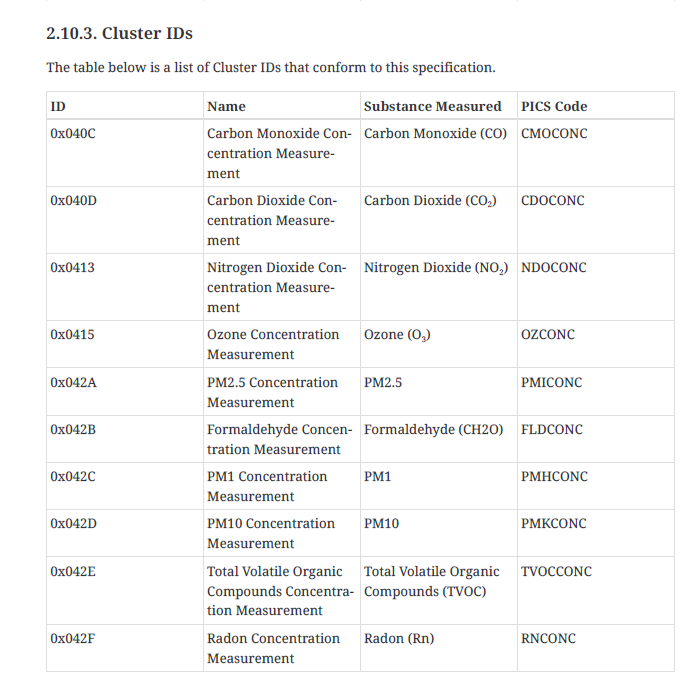

Well from what I can tell the device doesn't pass AQI values. If it did i would have implemented that as it follows the standard hubitat AirQuality device Capability. The big problem with AQI is that it is defined differently based on where you live in the world. The way i would calculate it here for the US may be different then if you are somewhere in Europe for example. Even worse is that AQI can be different based on the sensors available and the types of pollutants a country/region tracks for AQI.
What I implemented was directly from the "Matter Application Cluster" documentation. Now they could implement other clusters for sensors and use them to pass the raw data that is used to calculate AQI. That list is below. Several of those are used in AQI based on where someone lives.
