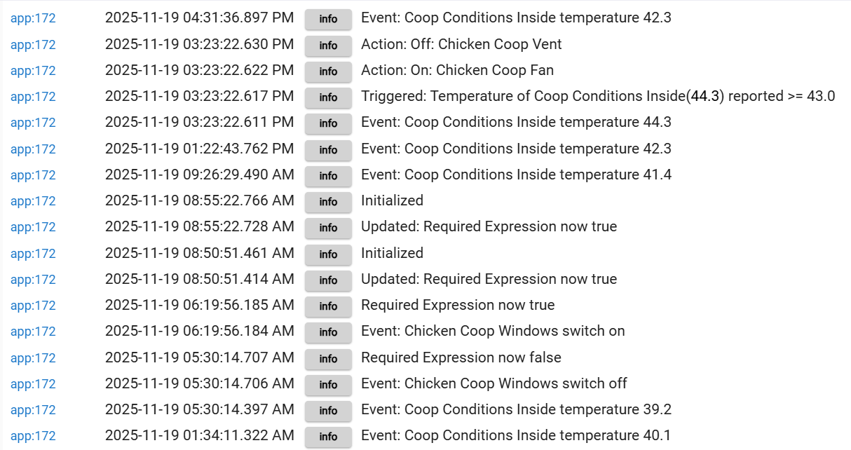

So it looks like it triggers sometimes. Today it triggered at 44.3 instead of >=42.

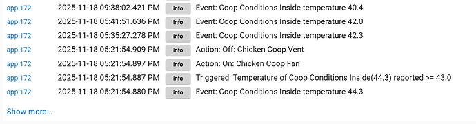

Yesterday it also triggered at 44.3 but not at 42. Thoughts???
42.x wouldn't ever trigger it as 42.x is always < 43, so those last logs there all look good to me.
As far as why 43.x doesn't work or works inconsistently, I'm not sure...
If it's ignoring the equal-to part for some reason as JLV mentions above, and something here (app? device? dunno) is having issues parsing decimals, that could explain it (i.e., 43.0-43.9 is being treated as just plain 43)

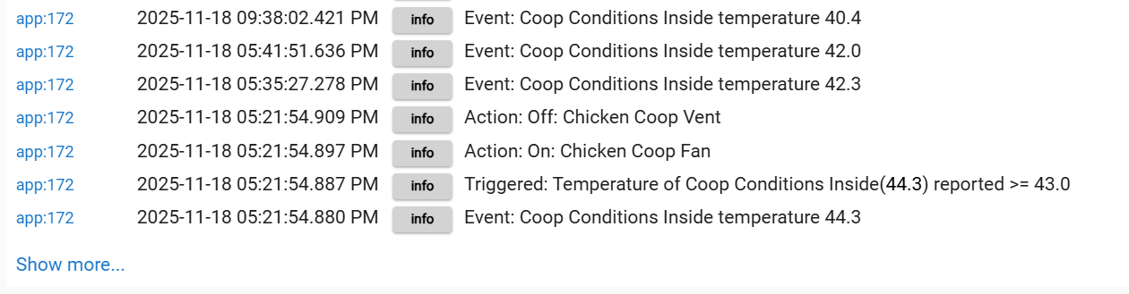

Yep-- I forgot I changed that by 1 degree (42 to 43) last week when I was trying to track this down. Best I can tell the decimal is the issue. 43.3 triggered it today, but previously it needed to be .5 or higher. Because of this issue, I raised it 1 degree (>=43) instead of 42 because the rule that turns it off is doing the same thing and I needed to seperate them a bit so they were not triggering each other. I don't recall this being an issue previously...
Please post another screenshot once you notice it not working correctly after adjusting the trigger back to >=42.
Thanks Sebastion. For now I'm going to leave it at 43. I have another rule that turns it OFF <42. So I think the decimals were causing the issue. I can live with a degree between the ON and OFF. I'll watch them all and post accordingly.
