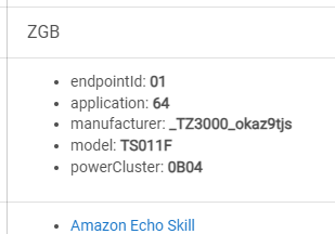

The device page shows:
The driver variables:

This is a non-standard Tuya device, you can't configure the reporting intervals as for the other Zigbee plugs made by manufacturers that follow the Zigbee standards.
You can search this forum for _TZ3000_okaz9tjs, which is mentioned in 22 posts.
Thanks... Should've guessed it was a TUYA... Installed the driver and it seems to work now!
