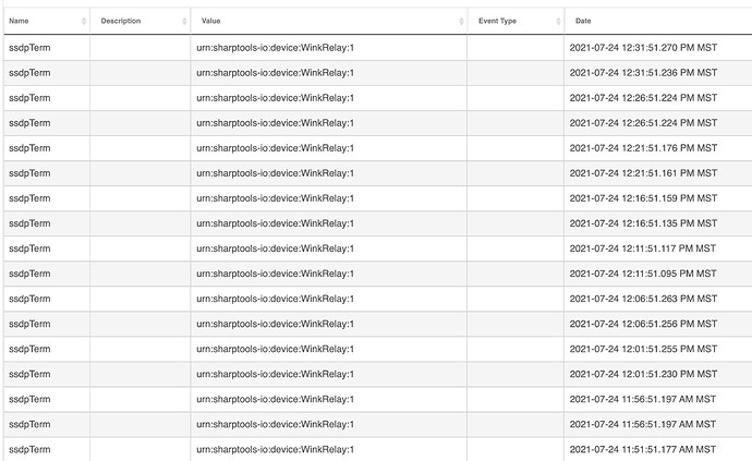

Repeating SSDP Discovery Events on a Wink Relay
I looked at/played with SharpTools very briefly. Decided not to use/pay at the time and removed it. Ever since I've been getting constant errors in the System/Hub events log (see attachment). Can't figure out how to fix/stop them.
\I've tried everything I could think of except deleting the Wink Relay device. I don't want to have to deal with the fallout where I use the Relay in apps, etc. I haven't seen any reports of this either.
Thoughts, suggestions ?
That's just the discovery that the wink relay integration does. They're not errors.
I'm the lead developer of SharpTools dashboards and I also built the Wink Relay integration so it uses the same namespace.
Why would it continue to reference SharpTools even after I removed the app?
And my other relay (I have 2) has never done this.
And thanks for the super quick reply!
It's not from the SharpTools app. It's from the wink relay integration. It just uses the same namespace. :point_down::point_down:
So.....
Is there an "easy fix" to stop them? If you noticed, they are being reported at a rate of about 4 per SECOND in the log. That can't be a very good thing :smiley:
Should be once every 5 minutes. You can search the wink relay thread and there are discussions about disabling the discovery
